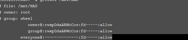

Which version of FreeNAS are you using and are you using the legacy or new WebUI? Look at the owner/group of "/mnt/NAS/", is it "root:wheel"?
When user "Michael" is in the "nobody" group, that account cannot enter the directory "/mnt/NAS/" and transverse to "/mnt/NAS/Backup folder". This changes when you place user "Michael" in the "wheel" group.

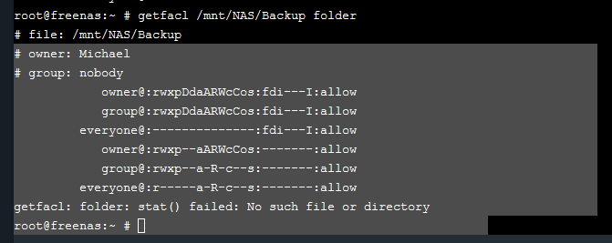

What's the output for these FreeNAS shell commands getfacl /mnt/NAS and getfacl "/mnt/NAS/Backup folder"

Your second getfacl command is wrong as you've fallen foul of using spaces in dataset names, which is probably best avoided. You didn't notice my use of "" above. Anyway, it looks like at some stage you've changed the permission on the root-level datset of your pool which is mounted at "/mnt/NAS" the owner/group are correct but not the ACL for the use you require, perhaps you created a SMB on "/mnt/NAS" at some stage. While user Michael is in the nobody group there is no acees to the next level down "/mnt/NAS/Backup folder". The fix is as in the thread I posted above. Use this command at the FreeNAS shell: setfacl -m everyone@:rxaRc::allow /mnt/NAS
