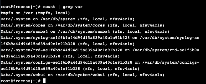

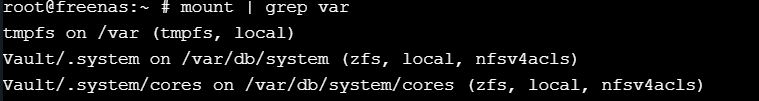

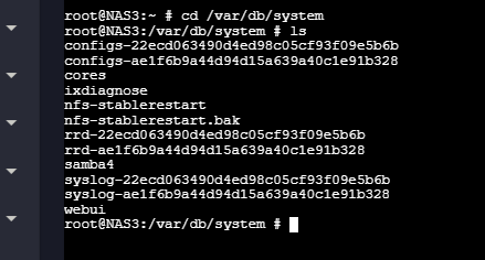

No, you want to look at the first picture in that post - you need to go to /var/db/system and look for the configs - study the second picture.
You won't see it in the gui - you can ,look for it in shell but SSH would be best.
Here's mine from shell:

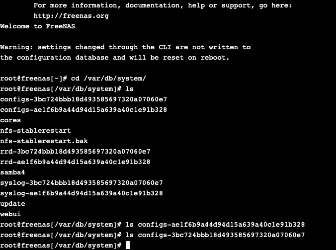

I should have mentioned that I'd already done that, and my two "configs-xxx" directories are empty (so I assume that data was not being stored on my pools).

Not really sure what your post/image was directing me to do, but here was the output of the same commands.
