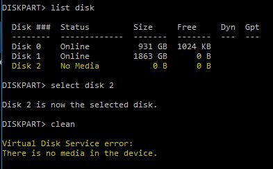

Does anyone have the same issue?
My FreeNAS has been setup as Mirror boot with 2 of 32G USB2 drive. One of my co-worker somehow decided to unplug the primary boot USB drive while it was still in use. The mirrored USB drive kicked in as it supposed to be. That's all fine.
The issue is that the unplugged USB can't be accessed anymore. I have this USB plugged into my Win10 machine. it showed as a removable device, but when I trying to access it, it tells me "please insert disk.... ". If I try to use "Diskpart", it shows me "No media" " size 0 " and "Virtual disk service error: There in no media in the device"
As well I tried to access this drive in Mac, Liunx (Ubunto, CentOS, FreeBSD), none of them can even detect this USB drive.
So how did FreeNAS format this drive so it can't be used anymore.....
How can I re-format it ? This is a new USB drive only being severed for less than 24 hours......

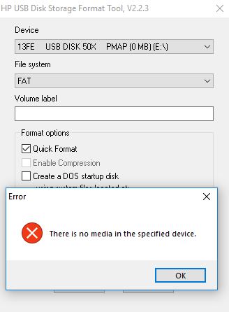

Try using the HP USB Key Utility for Windows. I have had success with it where nothing else worked.
Sorry, that was the wrong link,
This is the app I was looking for:
https://www.bleepingcomputer.com/download/hp-usb-disk-storage-format-tool/

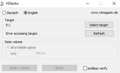

If this doesn't work, try some of the tools designed to detect and identify fake USB drives, such as h2testw (German link, https://www.heise.de/download/product/h2testw-50539/download) and see if a destructive write test on it will work.
