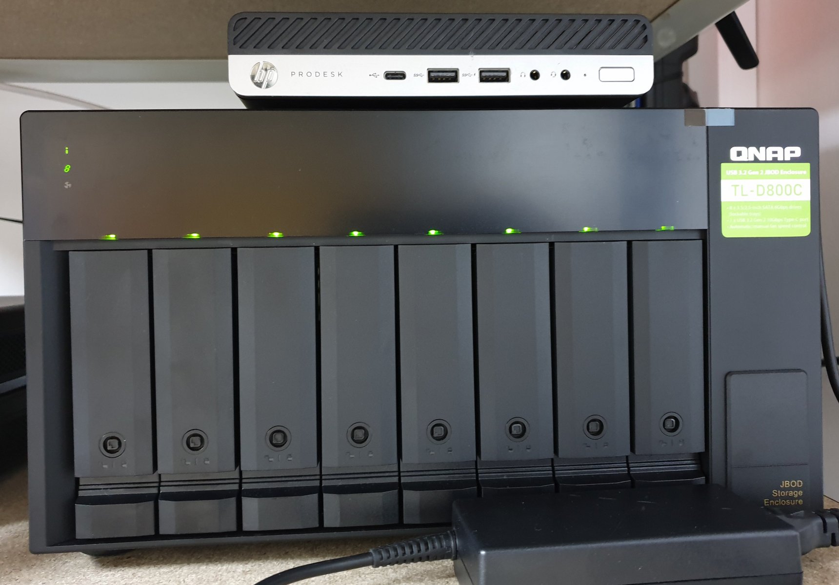

I use for FreeNas HP ProDesk 600 G4 USFF with connected QNAP TL-D800C 8HDD 3,5" bay which works perfect but I need to make faster internal network speed because all my main network infrastructure works on 10Gbps.

My main network NAS device is QNAP TVS-h874 connected with TL-D800S via SFF-8644 but because I had to send this main unit TVS-h874 to compain so for month or a little longer I don't have nothing to make any backup of data. I have only 24h to do this. So I connected this PC with TL-D800C and it will works quite good for 1-2 months. In future I planned that it will work only in such this ocasions.

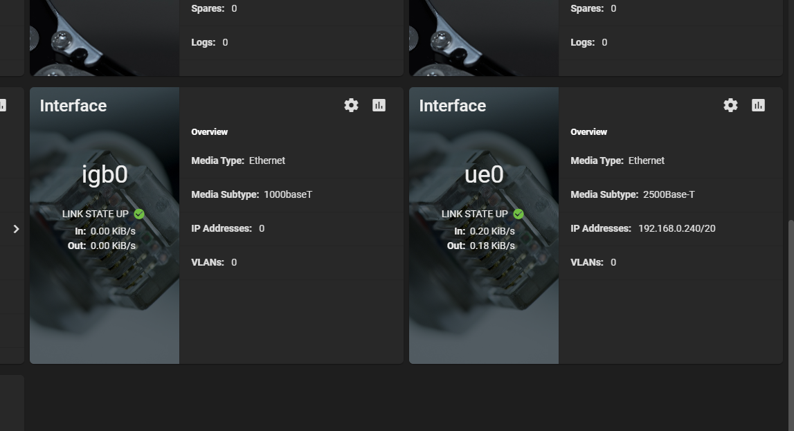

I have good news for you
After a full day of tinkering, I finally got it working reliably

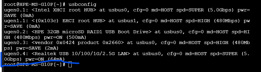

After doing this, you need to reboot to have effect. The network connection does not come up on boot however, to fix that, you need to reset the usb device (in my case 'usbconfig -d ugen0.4 reset' -> type usbconfig in the shell to find out the identifier on your system.

Can you post the output of "usbconfig" (see what @dafonehacker did above in the black screen capture)? It is very hard to tell what drivers SHOULD have attached if we do not have those vendor and product hexadecimal numbers.

usbconfig:
ugen2.2: <Realtek USB 10/100/1G/2.6G LAN> at usbus2, cfg=2 md=HOST spd=SUPER (5.0Gbps) pwr=ON (64mA)
