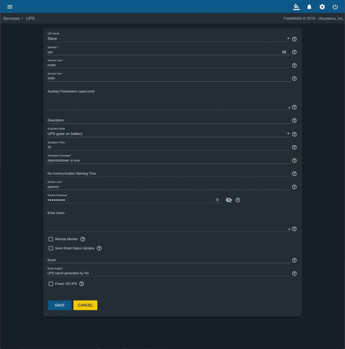

@Heracles yeah, I did that. Finally got it configured correctly on pfSense to act as the Master. And I hear what you are saying about referring to the NUT documentation. However, I am trying to figure out if I configured the service in the UI correctly to do what I want to do. It has options for shutting down 30 seconds after the UPS goes on battery power.
