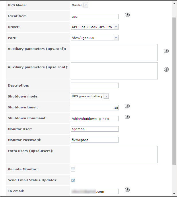

I have my FreeNAS plugged into the master outlet in my APC Back-UPS Pro 1000 G and the USB plugged into my NAS. When I initially did it it used /dev/ugen0.7 . After a reboot it changed to /dev/ugen0.4. Is that normal to have it change? After a reboot you have to adj the setup of the UPS in the services tab?
How do I know if everything is working properly? Will I get an email when I unplug the UPS as a test (for a power failure)?
It should not have an effect.
Yes, follow the directions in the manual. http://doc.freenas.org/9.10/services.html#ups
The log will show that the UPS is connected and if the settings and driver are correct, you should receive an email and the NAS should power down after a given time while running off the battery.

Where is the log file located? When I unplugged the UPS I didn't get a email. Does it only send a email if it is going to power down?
upsc ups@localhost

Here are my settings

Do you have your email configured properly under System > Email? Are you using the same email address for the UPS service?
You can view your log printout by using SSH and type in
cat /var/log/messages
I'm using the same email that is in system>email and I already get other emails from the system. Do I have to enable email for a user other than root?

@BigDave It turns out that the email needs the pw to be re entered after a reboot for it to work. The system does send me an email when I loose power to the UPS. Thanks for your help.
