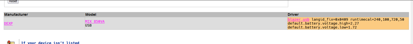

I just bought UPS DEXP MIX 850VA and I'm trying to connect it to my server but I keep getting errors. My UPS is in the list of supported devices

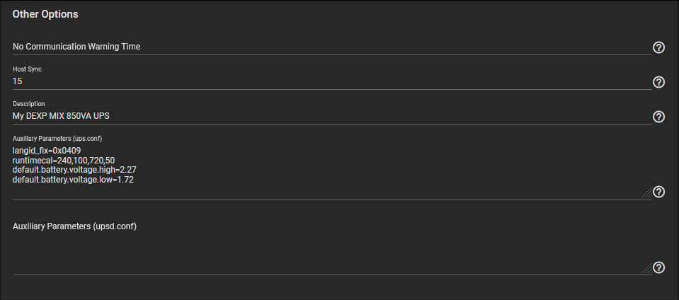

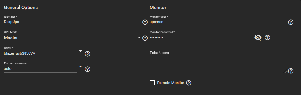

And my config. I didn't change user and password.
What am I doing wrong?

Instead of auto for port, try unplugging and replugging the usb and watch the terminal as to what address the USB port you are using is, then set it to that. But other than that i think it looks right.
Jan 7, 2015
1,155
I also have remote monitor checked, and have also jumped through a few hoops to get an UPS working i remember, but it was a long time ago. See if you can query it from a command prompt using
upsc DexpUps@localhost

Why isn't the driver in your config shown as just "blazer_usb" (but with no quotes)? Where did the string you have come from?

I choose a random blazer_usb driver because DEXP is missing in the pick list
Yes, I was part of the discussion, but where did the specific name you have come from - why is it not just blazer_usb? I'm wondering if this is why you are having problems - system looking for a non-existent driver...
It came from Appolo ups 2 850VA (blazer_usb). I also tried some other bazer_usb drivers but it didn't help
