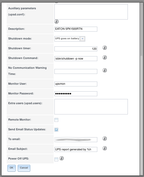

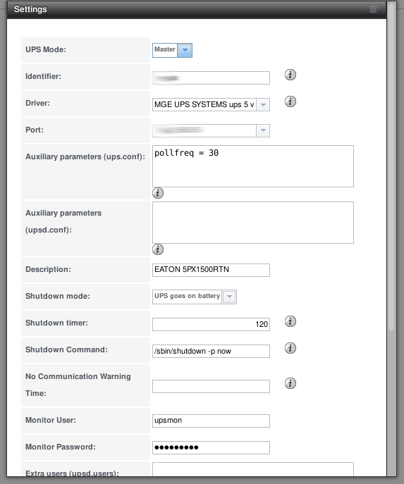

I was able to use the network card itself and connect my FreeNAS systems and my pfSense system to the UPS via SNMP. No USB or Serial cable required. For posterity's sake, here's what I did
  1. Select UPS Mode as Master -- since the system is going to talk directly to the UPS via the SNMP card.
  2. Put in an identifier to uniquely identify the UPS
  3. Select the closest driver compatible with your SNMP card -- I selected
    Eaton ups 5 various models (SNMP Mode) SNMP/Web Minislot Card (ref 66244) (snmp-ups)
    . Most times this is going to be snmp-ups for network cards. Note that if you go into the UPS Configuration setting after saving, it might have changed the driver that is selected -- This is because FreeNAS chooses any available name using the same driver (snmp-ups). I don't know why it does this but it doesn't affect anything as they all use the snmp-ups driver. Maybe this requires a "Nice-to-have" bug creation.
  4. Put in the IP address of your SNMP card/UPS as the Port value. It's best to assign a static IP to the UPS/SNMP card and not use DHCP because that may change in case of outage.
  5. Add in additional parameters if you want -- See here to check what parameters can be passed in. This also depends on what your UPS supports.
  6. Put in a description if you like
  7. Change the Monitor Password to what ever you like
  8. Enable Email Status updates and add in the email address that you want the updates sent to
  9. Keep Remote Monitor disabled
  10. Power off UPS -- I kept this disabled because I want FreeNAS to shutdown but I want my internet(modem, router, switch & AP) to keep working for as long as possible. You can choose to enable this if the UPS is only powering your FreeNAS box or if you want everything connected to the UPS to shutdown in case of power outage.
  11. Click OK and start up the UPS service and enable "Start on boot"
Repeat the procedure on any other FreeNAS box that you might have on the network.
Hope that helps

Inxsible
Aug 14, 2017
1,123
I had no idea I could do this with the network card, will definitely look in to it.
Well yeah ! Since it's a network card, every network device can talk to it directly. No need for another device in the middle to be a Master etc.
Not much in terms of pfSense UPS settings:
I just changed the pollfreq from the default to 45 seconds because I think it suffices. I have an Eaton 5PX1500RTN UPS and pfsense communicates directly and so does FreeNAS
General Settings
    UPS Type : Remote SNMP
    UPS Name : "whatever name you like, I just named it the same as my ups hostname"
Driver Settings
    Remote IP address or hostname: "your hostname or IP"
    Extra arguments to driver : pollfreq = 45
Also, did you have to log in to your UPS to adjust any settings? I am using an Eaton 5px3000va/2700w
I did log in to the UPS to set up a few things, but they are unrelated to the pfSense configuration. I was hoping for the UPS to send me emails etc directly when it went on battery power and a bunch of other Alerts -- but the UPS' network card (Network-MS) doesn't support TLS (or at least there is nothing where I can set that) so all the emails just fail and I can't send them over.
I researched and it seems the general consensus is that usually these UPS' are used in Enterprise environments where they have a separate mail server within the same LAN network where it could be forwarded. For me though, it was too much of a hassle, so I just used the UPS scripts available on FreeNAS forums to get me the information I wanted.
Sir SSV
Jan 24, 2015
96
General Settings
Driver Settings
Thanks for the pfSense configuration. Is it possible to have both the FreeNAS and pfSense pollfreq set to 30 or would this cause a conflict?
Also, as per your screenshots of the FreeNAS UPS setup, the monitor user and monitor password is this set up via the Eaton gui?
I also read on nguvu.org (https://nguvu.org/pfsense/network ups tools (nut)/pfsense-ups-nut/) to set extra arguments regarding low battery warning to 20%. Is this something you had to do?
Inxsible
Aug 14, 2017
1,123
That should be fine. I have both my pfSense and FreeNAS set to 45.
No not from the Eaton gui. These are the user/pass that you set up in the NUT configuration. I think it's the upsmon.conf file.
No I didn't do this because the default low battery level for my UPS is 20%. I think that's the default for all, but I could be wrong. I would change it only if you want to override the default low battery level to anything other than 20%. Going lower risks not cleanly shutting down all devices before the UPS loses all battery power depending on how many devices you have connected.
My initial goal was to shutdown FreeNAS, 5 mins after losing AC power and keep the other devices running until 20% battery remained. During my research I found that taking the UPS batteries that low in charge will kill the batteries much faster. So now I just gracefully shutdown all possible devices 5 mins after losing AC power.
My dumb switch and an old Wifi AP (DD/WRT) just die for lack of power after 5 mins -- as there is nothing that I can set up for shutting them down.
