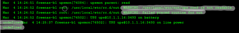

While I'm thrilled that I have a working and much more robust battery backup arrangement for the GEN 7's, what's curious are the console messages I'm seeing on both machines. In the screenshots below, I've highlighted what appears to be erroneous output.
On the master...

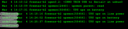

On the slave...
