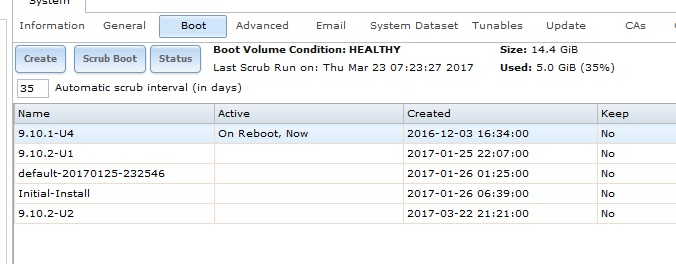

From the GUI, on Boot tab, deleted some of the older boot environments going back to 9.3.
When there was enough free space on the flash drive, succeeded in doing an update to Corral.

Rebooted FreeNAS again and from the console selected boot environment 9.10.2.
This is now working and SMB and Shares are usable.
Then from the 9.10.2 GUI, Boot tab, deleted the Corral boot environment, with the intention to re-install and start again.

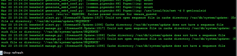

But it seems the Sequence file has got lost and I cannot do an update, can only change boot environment.

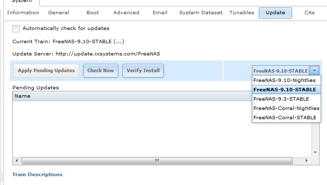

The system also seems to be confused about the loaded trains. See attached screenshots.
I cannot find any online advice on how to restore the sequence file unless I first do an update, which FreeNAS will not do because of the missing file.

From 9.10.2 GUI, selected update, selected manual update and picked the Corral .iso from on my networked Windows PC.
Hmm, I don't think that's supported or that the Corral devs thought of that one in their migration script....
Are things back to normal if you select your U2 boot environment and boot into that?
If so, I'd recommend staying on U2 for now as the Corral installer currently has a bug where you can't install into a new boot environment: https://bugs.freenas.org/issues/22685.
