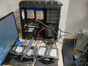

i dont have any experiance with rsync, and i have only ever done this procedure https://forums.freenas.org/index.php?threads/copy-move-dataset.28876/#post-190056 to move my stuff around. And you dont need bays....you'd just need ability to connect the hdds :p i cant find the photo i wnat...but i have done a migration of 8 hdds, from 1 RAID 10 to another , it took me 2 SAS to SATA break out cables 1 for each RAID 10 and a few molex to SATA power adapters lol
EDIT: found the photo i wanted, sorry for the crap photo quality it was recovered from my now dead iphone.
P.S This photo predates my FreeNAS server and all my other servers in my current lab lol, so when i say RAID 10 it was HW raid
