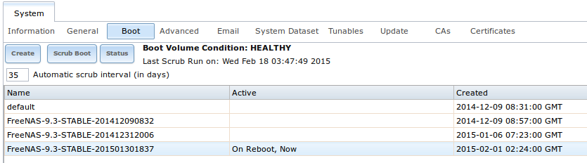

Just to verify, how big is the boot device and how many BEs are displayed in System -> Boot?
Unless there's a way to work that out from the command line, you'll have to wait until I get home before I can tell you that...

...how many BEs are displayed in System -> Boot?
And the answer is: Four.
FreeNAS Screenshot - 03202015 - 10:24:19 PM.png

OK, but the manual says you should have an 8GB boot device minimum. You have about 1/2 of that, and during the upgrade process you need free space above and beyond what you normally need.
So I think the answer to the problem is "user configuration issue" due to inappropriate hardware.

I'd suggest a check would be to delete all but 2 boot environments through the gui to see if freeing up space fixes the problem. Not sure why one would need more than 2-3 versions.
