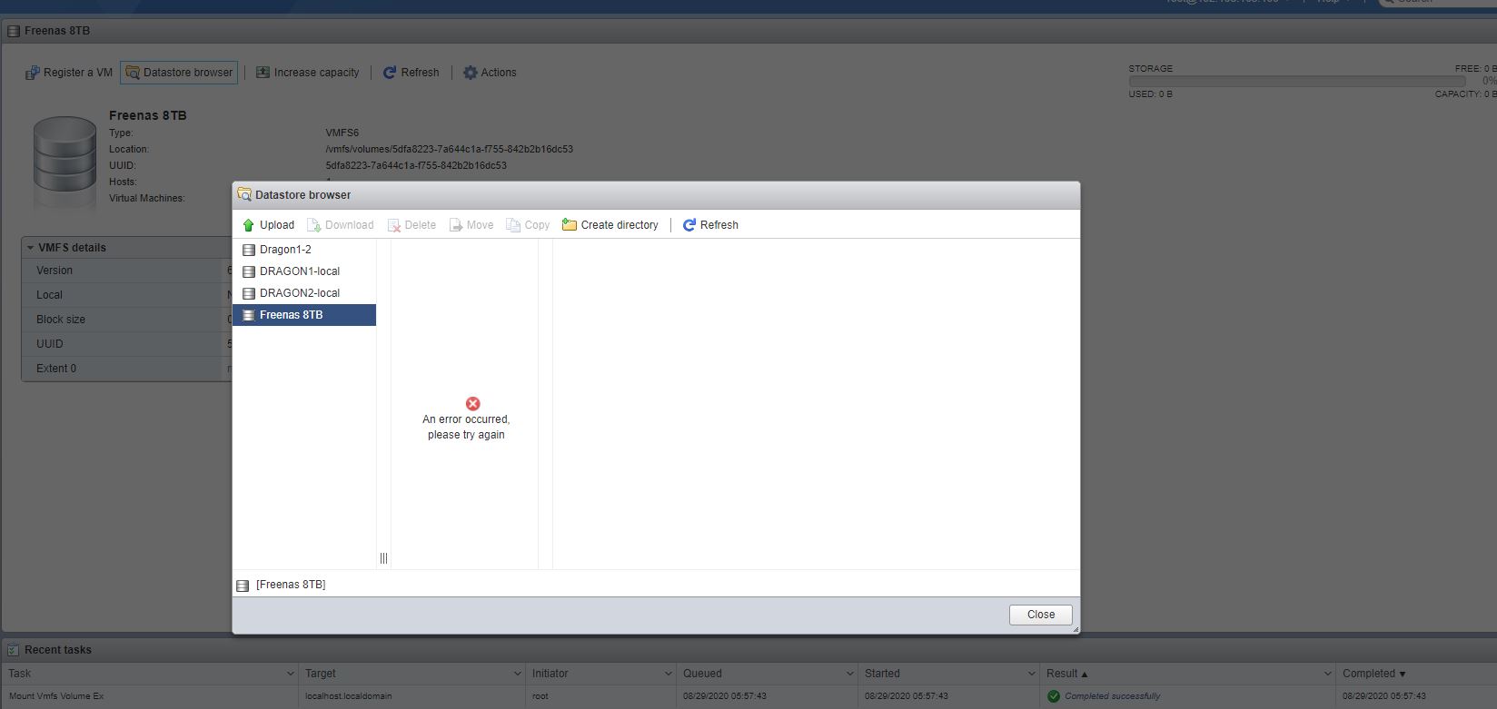

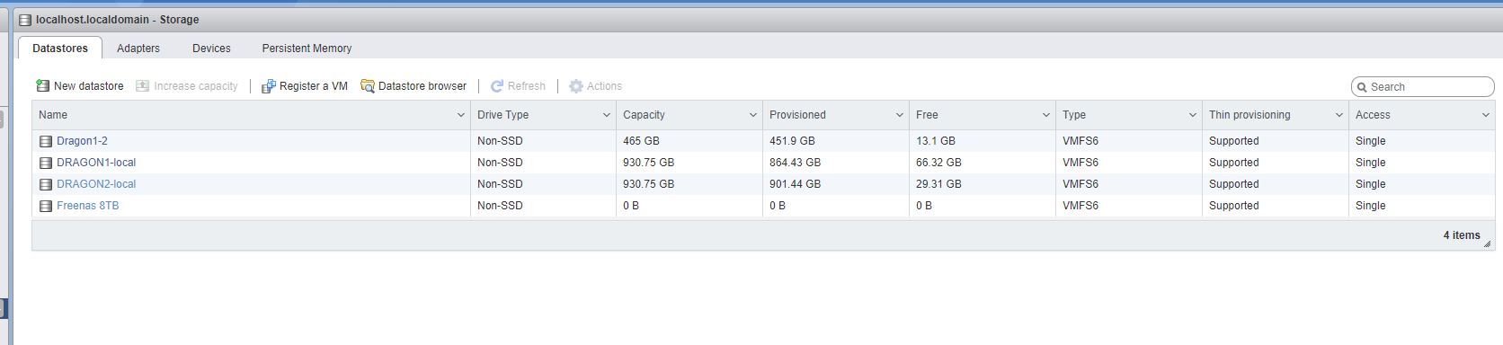

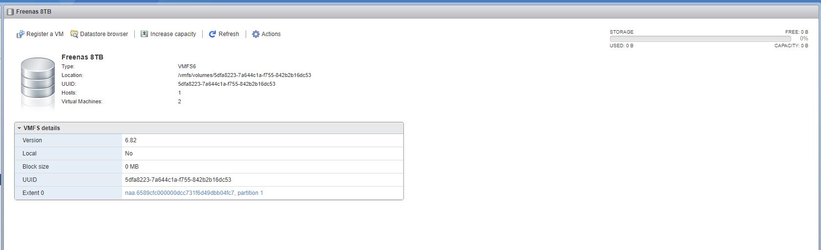

seems like vcenter and 100 hosts sees the freenas storage 8TB, but when I click on view datastore I have error:
an error occurred, please try again
