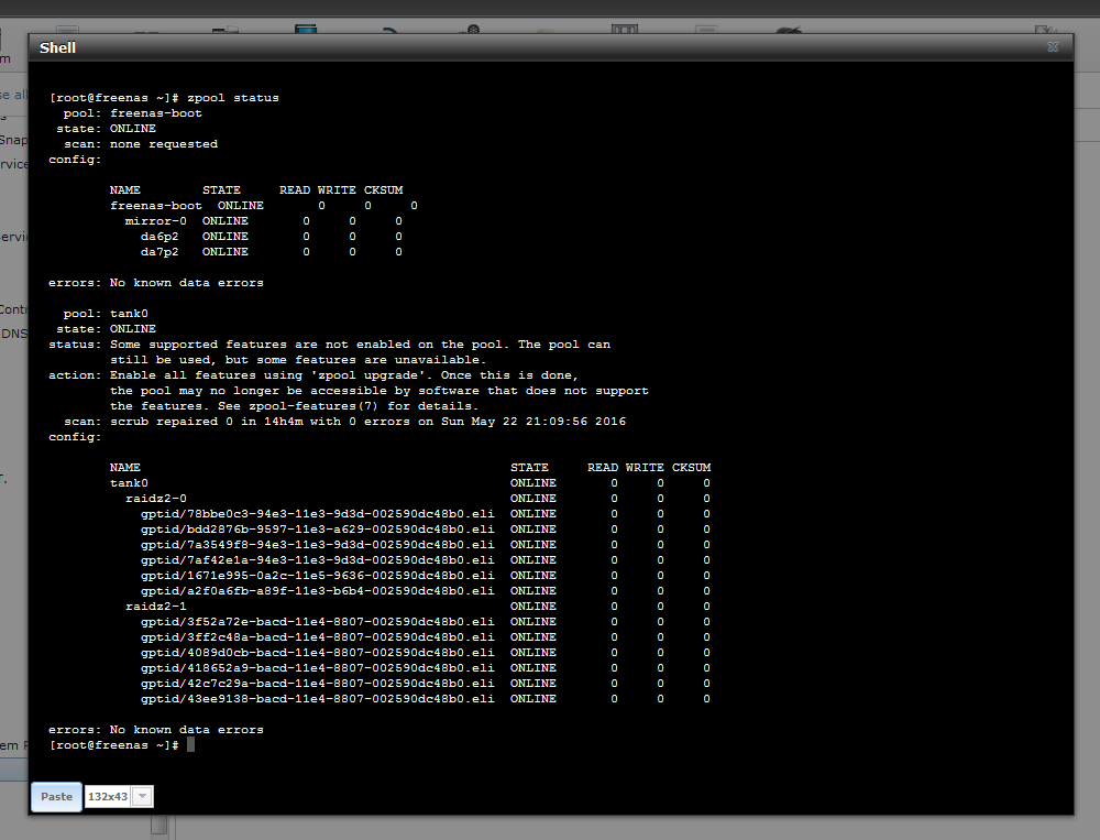

But then I wanted to import the zpool via the web interace, selected my 12 drives (2x raidz2) and decrypted them successfully, but then in the dropdown list to choose a zpool nothing came up. So I decided to use the shell and just typed "zpool import tank0" which seemd to have succeeded at first glance:

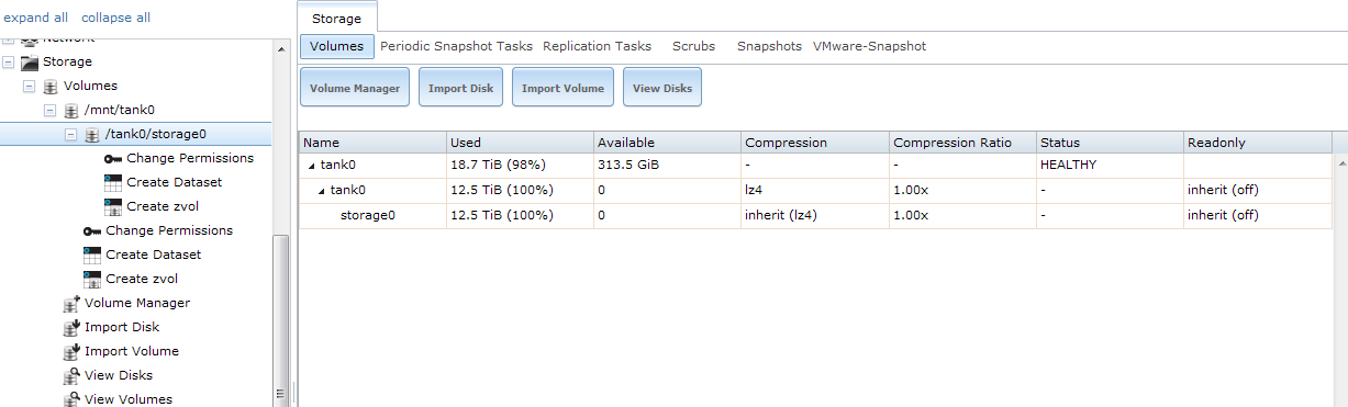

But I noticed the mount point wasn't set and I looked at the volume in the web GUI and this doesn't seem right at all:
First of all my zpool should have a configuration "tank0->storage0" and not "tank0->tank0->storage0". Where did that intermediate tank0 com from? "tank0" is the zpool and there wasn't any dataset called "tank0" in that zpool.
Secondly the Dataset storage was 18TB in size not 12TB. There's a whole raidz2-vdev missing, maybe? Although all vdevs and drives show up as being ONLINE in the "zpool status tank0" output. And 18TB can't be right either, the full zpool was at most ~14TB (4x 3TB + 4x 500GB).
It may have something to do with the firmware mismatch of my IBM ServeRAID M1015 being v16 and not v20, but the disks decrypted successfully and reading them with "dd" also succeeded. So I doubt it's an issue, although I cannot fully cancel that out.
There was always a dataset called tank0 (a pool always contains a dataset of the same name), but it was hidden prior to 9.3. And no, there's no vdev missing--if it were, the pool couldn't be online.

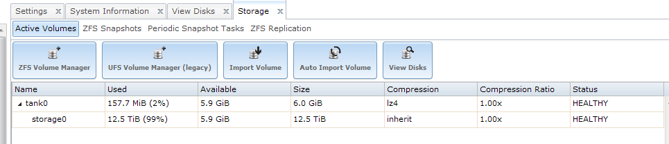

So I booted up the 9.2.1.9-stick and all works fine. Damn that was close! I almost lost my whole pool. This is how it should look like?
So the 12.9TiB was correct after all. I guess I mixed up the SI TB of the drive manufacturers with the ?th power of 1024 the TiB is referring to. So where the extra 6TiB came from the the odd 313GiB of free space just puzzles me. The missing mount point might have been due to unsuccessful importing via the shell command "zpool import tank0" I issued.
