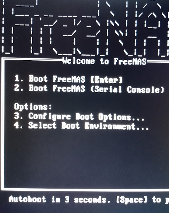

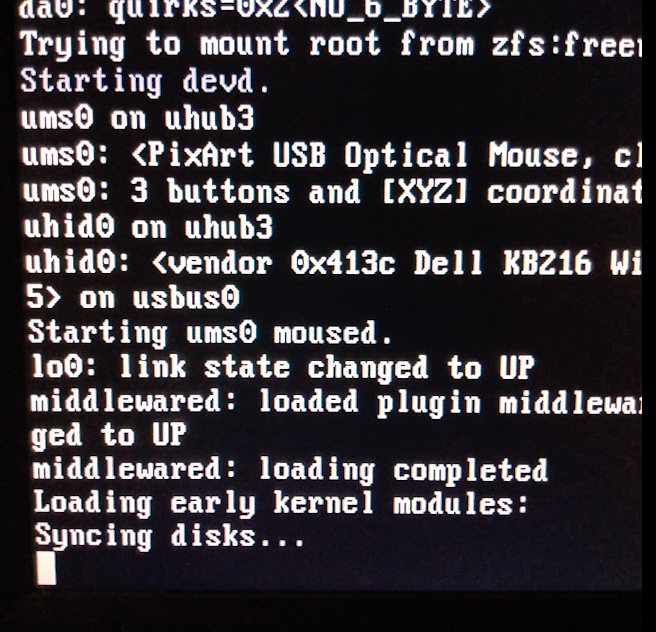

My issue is that when system reboots off the USB drive (i vaguely remember that that's where FreeNas is written to and it only uses the 4TB Red for storage) it hits the loader screen that allows me to choose either boot FreeNas normally or via console, and then it runs through a pile of lines of launching scripts, but it hangs each time at a line that says "syncing disks". I've let it run overnight and it sticks at that line.
I can get past that by hitting enter a few times, and for all appearances FreeNas appears to be running and I can get into the GUI etc.. but that doesn't leave me with a warm/fuzzy.

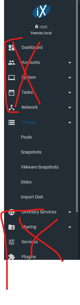

Also, coincidentally or not, none of the submenu items are clickable on the GUI for the system. The only access I have to submenu items in the GUI is where it lists Storage

Thanks for the reply. the line that says syncing disks is a line item that appears maybe 3 dozen lines after the initial auto-boot ASCII Freenas menu has left the screen on launch. I'll get a SS of it.

That 2nd SS (syncing disks) is the part where it hangs.

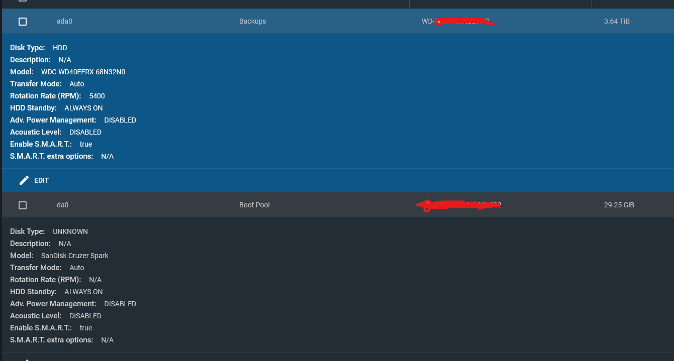

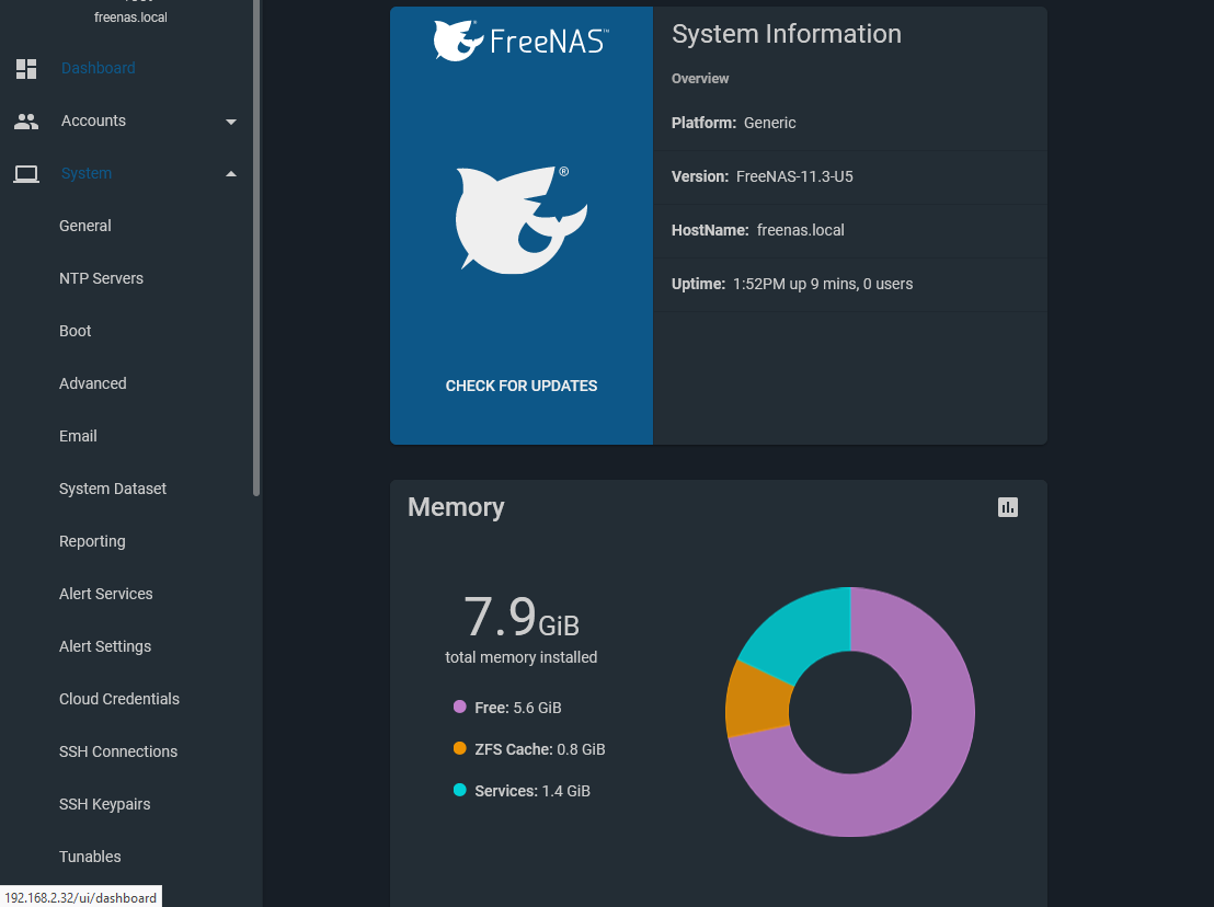

How old is this hardware? How old is the USB drive? Can you upgrade the memory to 16G?

I think it takes DDR3 and only has 2 slots. It looks like the board supports up to 32GB though so that's an option if you think it's a game-changer and it's "only"~ $45 on amazon it would appear. (16GB KIT(2x8GB) DDR3L)

And again: do you really have just a single HDD in there?

Just the single HDD. I'll try a different USB stick and import the pool if I could just get the dang gui to respond to my clicking.
The only menu option I can click on and have launch successfully are the Storage submenu items. I'm a bit concerned about getting the new USB stick to import the pool properly because iirc from my reading that's under System and while I can SEE the submenu items there, I can't click on any
