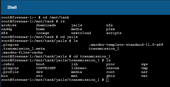

I upgraded to 11.3 and lost the ability to start my warden jails.
I would really like a way to at least get them up and running temporarily to grab all the settings and configurations I have in them.
Anyone have any suggestions on how to do this?
Jan 4, 2014
1,644
The jails are still there. You just can't run them, but you can get to the data in them. You just need to trace their location in the pool. You can do this from the Shell e.g. in the screenshot below tank is the name of the pool so /mnt/tank represents the root of the pool. From there, use a combination of ls and cd commands to find the data you're interested in.
