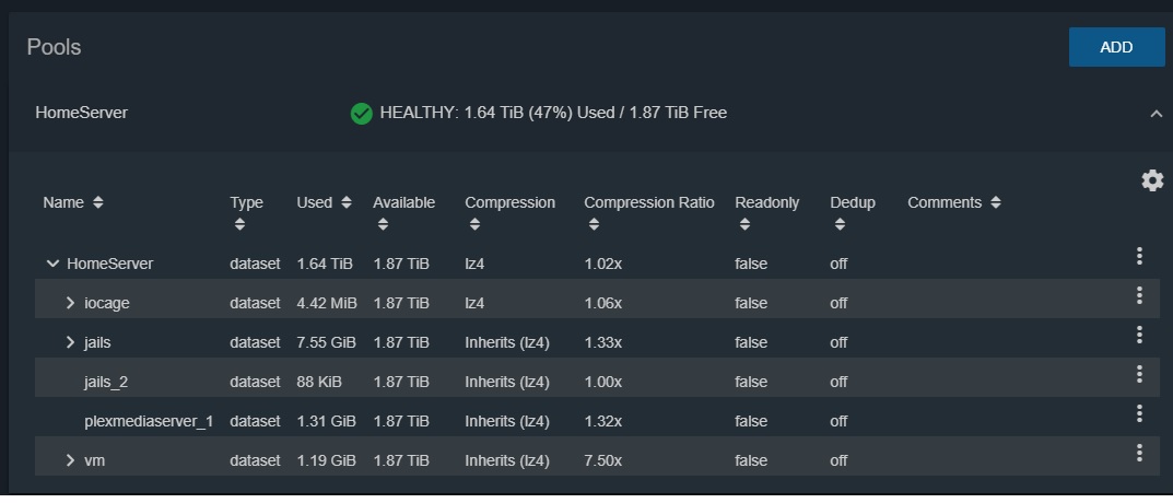

Ok, I have imported my old pool on my new 11.2 U7 clean installation of freenas. Please see attached picture. Now the question is, what other steps should I follow so I can access my "\\freenas" from my windows networked pc. Currently I cannot access \\freenas to access my pool data.

Where is your data? It is not obvious from the screenshot you provided. Did you set up Samba shares for your data folders in order to access them from Windows?
After the clean install on new pen drive, I have simply imported my previous pool, nothing else.
Can you please write me the other steps in order so I can try to complete those.

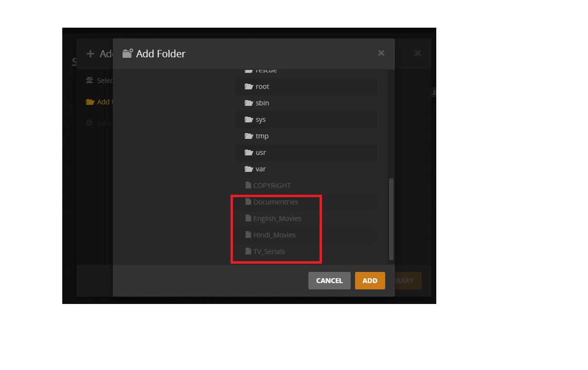

Thank you very much. I am able to map my folders in freenas now. The only problem now I have is, after installing Plex plug-in, when I try to add the folders on the plex library, the folders are showing greyed out. See the attached file and advise how I can fix this?

You need to add the folders where the data is to your Plex library. I would suggest that you consult the Plex documentation for help with this. They have a user forum as well that might be helpful.
The Plex User of the jail needs proper permissions to access these folders.
Fix these permissions with setfacl/chmod commands from the FreeNAS shell or via Windows
with the properties dialog and set read permissions for everyone in the security tab.
Also check the Plex subforum, this has been asked (and answered) several times in the past.
