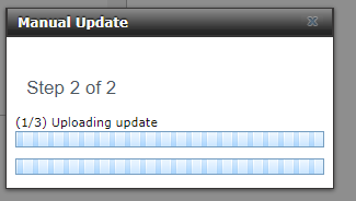

Hello,
I am looking for the appropriate link to do a manual version update for a unit from -9.10-STABLE. The versions i have been able to find do not appear to push to the unit properly.
Bradomski
Mar 9, 2018
7
Well, as stated in the post, the box in need of the update resides in a COLO that is isolated from the outside network. So, i cannot do the "pull" update from the network. I am just looking for a download location to do a manual update "push" style to this box

7
So, I will restate the original question. The Freenas in question is in a remote COLO. I have internal network access to the unit, but that is as far as it goes. I cannot allow this machine to directly connect to the internet to pull an update. I want to upgrade it to the latest version 11-U2. I just require the "manual" update files for this version as the versions provided in ^ post dont appear to do anything to this unit.
It will sit here for a good chunk of time, and then just refresh to the home page of the Freenas box as if nothing was uploaded.
