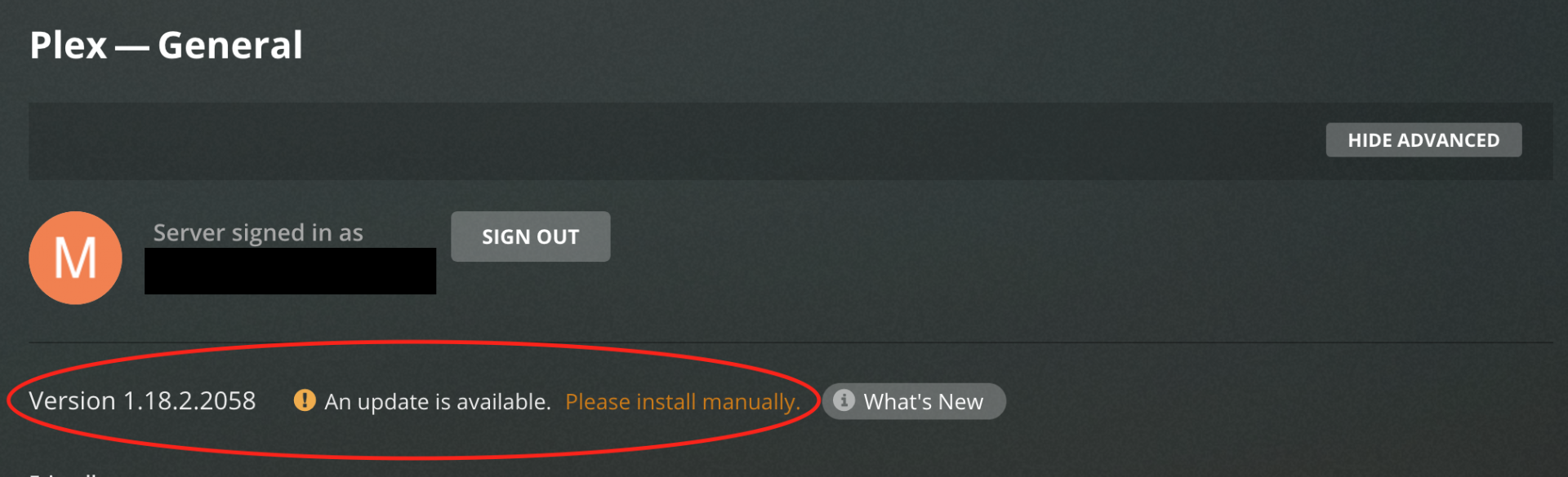

I have installed Plex on my FreeNAS 11.3 server and it is working well. However, Plex is indicating there is a server update and to install it manually (of course, as it should be). I have not been able to find online any guides on how to do this. Could someone point me in the right direction? Thanks - any help will be appreciated.

Oh - and Plex is intalled in a Jail. I am not using the plugin.

Leave the jail running and ssh into FreeNas. Once you do that, type "jls" into the command line. Your running jails will have ID numbers. Whatever jail ID your plex is running on, run the command "jexec 4 tcsh" (Change the number to whatever jail ID your plex is on). This will get you into your plex root. From there, run the command portsnap extract (might need to run "portsnap fetch" first, if you havent used ports before). Once thats done scrolling and loading a ton of ports, run the command "portsnap fetch update". After that, command "cd /usr/ports/multimedia/plexmediaserver-plexpass" to get you into the directory you need to be in. Now run the command "make deinstall" Then finally run this command "cd /usr/ports/multimedia/plexmediaserver-plexpass/ && make install clean" This will install the latest version of plex. If your not running plexpass version of plex, just remove that text from the commands. Restart the jail for the changes to take effect. This is just a quick run down of how i do it. Works for me, others may do it differently.
