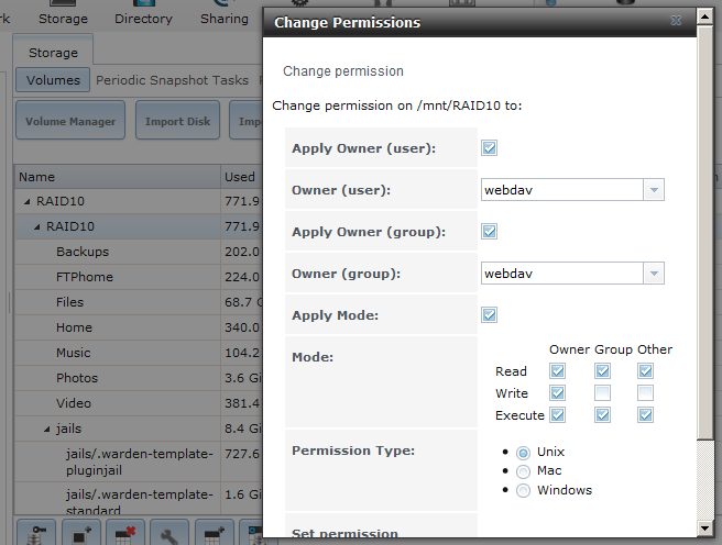

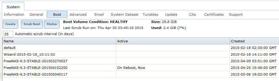

My CIFS shares can no longer be written to from PCs. I tried rolling back to an earlier boot config... No help.

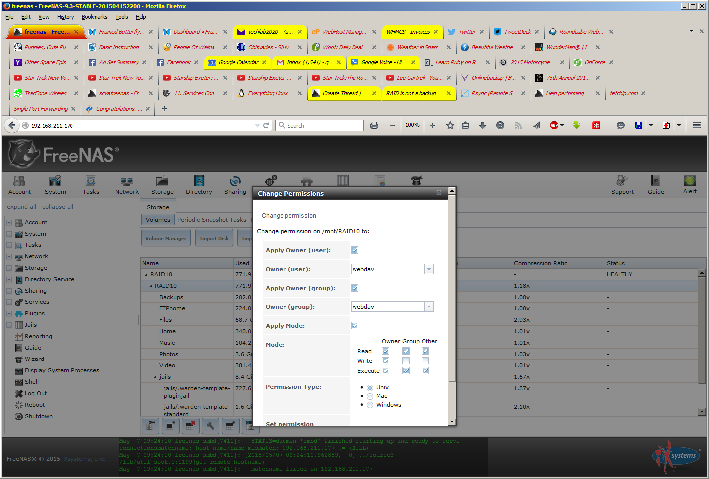

You can see the problem in the screen shots below.
I need to correct my volume settings now, but I do not know what all the settings in that now-wrong dialog box should be!
Can someone please help me reset permissions on my volume?

I'm using webdav (secure with https) and those settings you have there are exactly the settings I have for my webdav dataset. /shrug
I am using the latest FreeNAS build though. ;)

That volume is *not* a dedicated "WebDAV" dataset.
That is the entire storage pool from which any and all shares (including CIFS) are served.
I can worry about the secure/insecure access later but for now I need the entire "RAID10" storage pool made accessible again according to settings under "Sharing".

Well, if you overwrote all the volume permissions with those, then you've got a hell of a lot of permissions to fix. Sorry, but that kind of problem goes far beyond the scope of what I can easily discuss in the forums.
You're going to have to fix the settings to work for CIFS while simultaneously providing appropriate permissions for WebDAV. This is *very* advanced permissioning because CIFS uses ACLs and WebDAV uses Unix permissions.

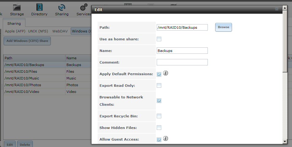

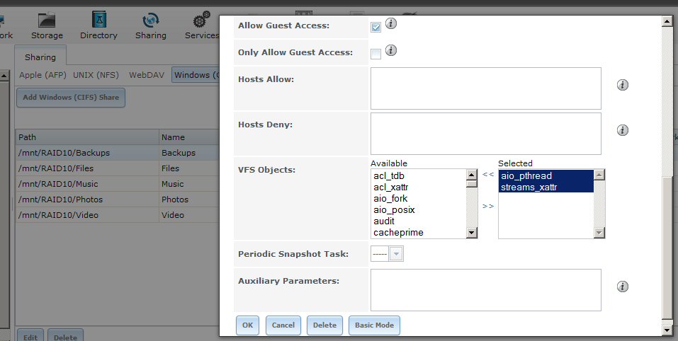

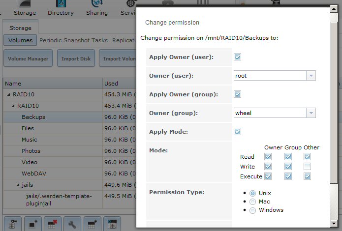

Below are screen shots of the config/permissions for one example CIFS share & dataset.
If you can tell me how to get he debug file from advanced settings I am all ears! I see "Advanced" under "System". I see "Save debug" but I want to be sure that file contains whatever it is you need to see.
Dataset permissions.
You'd have to scroll down to see "Set recursively" which I did select and apply.
Share config for same dataset (top half)
Share config for same dataset (bottom half)

So the only user that can write to that dataset is the root user or a user that is in the wheel group. All other users can only read and execute from that directory. What do you think it should do? What user are you logging in with?
mudshark
Jan 17, 2015
119
Should be able to read / write these shares no matter what Windows User you are logged in as. Works that way before a WebDAV install!
SweetAndLow
Sweet'NASty
Nov 6, 2013
6,421
No it didn't, not if this was the permissions it had before.
