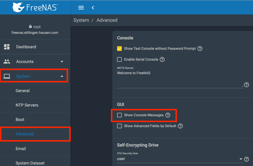

I would try disabling the mini console first. Does that help?

Now comes que silly question (sorry!)
Is that possible? I have been looking for a setting and I haven't seen it.

Scratch that, sorry! For some reason I didn't see it. Now I've disabled it, testing.
