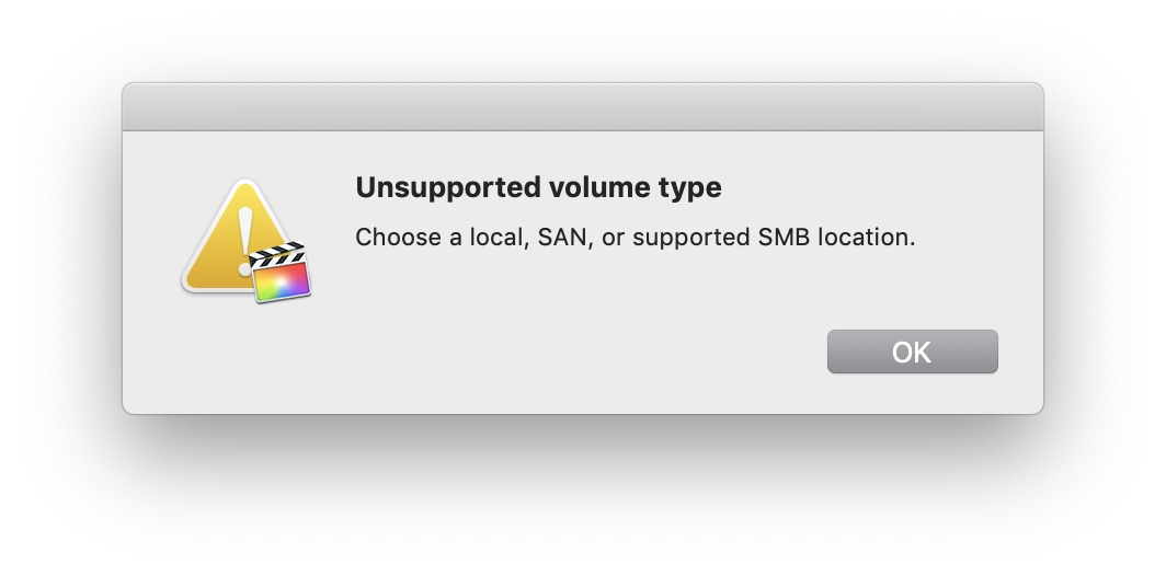

When trying to use my FreeNAS which holds my FCPX libraries with FCPX on MacOS over a smb:// share I get:
I heard that FCPX will work with Libraries on network shares if the share is fast enough. I have a wired gigabit connection here. Is there something I am missing??

This may work better in the next update as we have bumped the Samba version for better Apple support.

A quick google search took me to a apple support page https://support.apple.com/en-ca/HT207128 stating vfs objects = catia fruit streams_xattr
need to be enabled on the server for Final Cut to work that is were i would start looking into the problem. @anodos seems to be the SMB guru but i'm not sure he has a MAC to test with
Yeah, I use a Mac daily. Supporting them is complicated. :) In recent versions of FreeNAS, enabling fruit should configure most of what you need. It does not turn on Catia (I may add a checkbox for that later, but I'm somewhat disinclined to add new things to the UI without pulling out some things).

on the line that says vfs_objects the arrow on the right will display a list you can then check fruit and catia

on the line that says zfs_objects the arrow on the right will display a list you can then check fruit and catia
Whoa... whoa... it works! FINALLY OMG.
