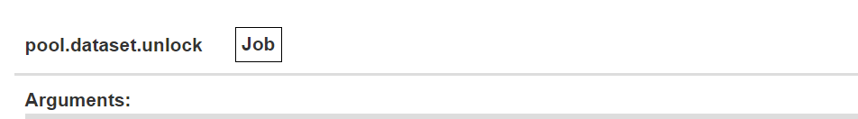

That thread is very old and for the v1.0 API system. You'll need to do similar with v2.0:
Take a look at this API call:
You should be able to call it from the CLI using 'midclt call pool.dataset.unlock <properties>'
