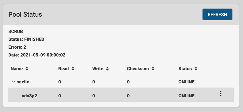

One of my pools is marked “ONLINE (Unhealthy)”. I expected some kind of detailed information nearby or as a tool tip. Couldn’t find anything. What exactly is wrong and how can I fix this? What does TrueNAS mean by “unhealthy”?

If you have a look under Storage | Pools and click the cogwheel to the right and then Status, you can see what's going on.
Actually, since you captured that screenshot from the dashboard, you can just skip straight to the cogwheel on the same "card" to get to the status.

Thank you for your answer. I clicked on Status, it shows me this:
Now I know that it’s actually 2 errors, still no details though.
9,700
OK; so we'll need to switch to the CLI/shell to find out more.
if you go to the shell and type zpool status -v we should see something similar, but hopefully a bit more useful.
