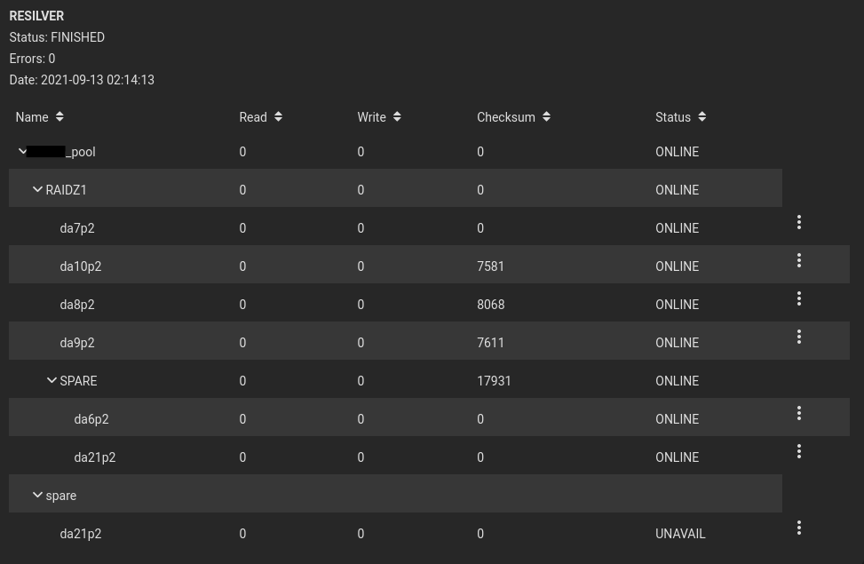

First, a little background:
I was in the process of removing an unused pool, and its drives, when I accidentally pulled a drive from a different pool. The pool had a hot-spare configured, and immediately started resilvering. I didn't want to break anything, so I just let it do its thing. Now that the resilvering is done, the pool is left in a state that I've never seen before, and I don't know what to do.
In the attached screenshot, you can see the status of the pool. Disks da6 through da10 are the original drives in that pool, and da21 was the spare.
da6 was the drive I accidentally removed. After resilvering, da6 and da21 both show as spare, and the pool shows an "unhealthy" status, and da21 shows as unavailable.
I can't figure out how to move da6 from spare back into the pool.
