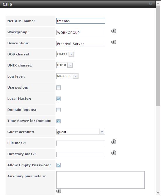

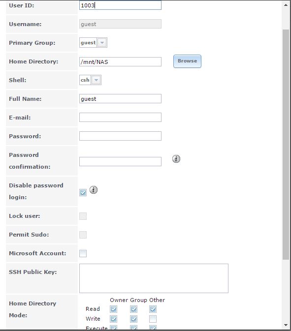

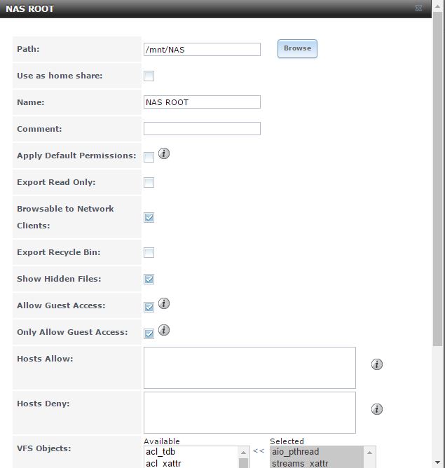

I recently upgraded to 9.3.1 and everything appears to have been imported correctly, however I am unable to write to the share. I can view and open all files but cannot write. I tried on two different clients so it doesn't appear to be related to a particular workstation. It seemed to be a permission issue in my mind so I checked the permissions for the guest account (I use guest access without authentication since this is just a small server in my home). There was only one box unchecked under home directory mode. If I check this and then save it appears that the save doesn't stick. Not sure if this is the actual issue or not, because the share isn't my home directory, but all of the other settings for the user, the share and CIFS appear to be OK. I have attached some screenshots, in case there is a setting I have overlooked. I haven't altered any other settings

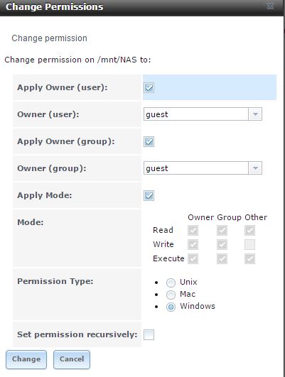

I wanted to add a screenshot of the permissions for the dataset. Looks like I missed that (haven't changed anything)

Probably not best practice to share the root of the pool. Ideally, you should create a new dataset setting the type to 'Windows' and giving your user full read/write access that way.
pdoten
Mar 27, 2013
24
Change the "Owner (User)" on your dataset to "nobody" and try it again.
Tried that, didn't improve the situation. Also tried changing both the owner(user) and owner(group) to "nobody". That did not do it either
