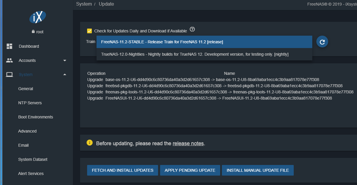

unable to switch Train from 11.2 to 11.3
Keven
Aug 10, 2016
114
Hi, i am running 11.2-U6 and i want to upgrade to 11.3-U2, but i am not able to see the train, i only see the 11.2 stable and the 12 nightly. am i required to go to 11.2-U8 before going to 11.3 or it is supposed to work from 11.2-U6? i have cleared the cache and click on the refresh button for the Train.

I just discovered I am in the same situation...
I just brought one of my 11-2-STABLE machines up to FreeNAS-11.2-U8 (EOL) with the intention of then continuing to 11-3...
The upgrade to FreeNAS-11.2-U8 went fine but now I find I am not offered the 11-3 train.
Help! :)

Courtesy of @Patrick M. Hausen : "Try midclt call update.set_train FreeNAS-11.3-STABLE from shell"

Yeah in the end I did the same it went fine... I think so far.
