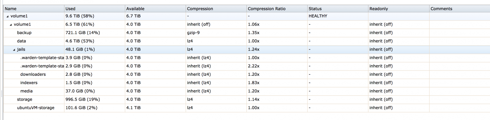

Which makes sense as it not mounted - Im not really sure what I should do here - should my zvol be mounted ? Below is my current setup within the Freenas GUI for my storage.
Is this look ok ?

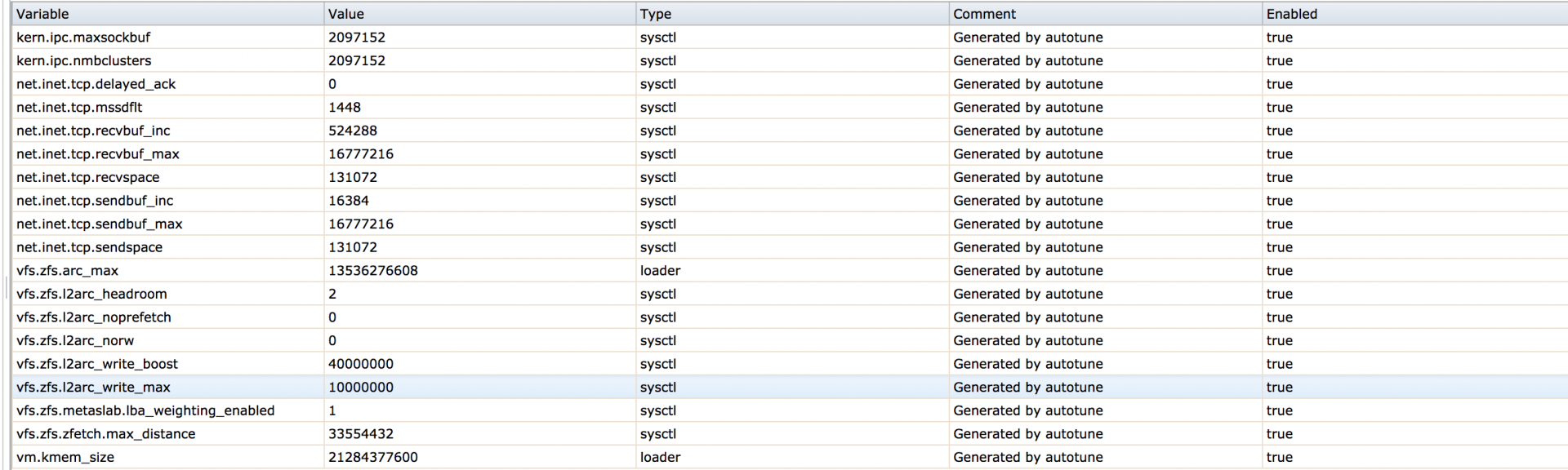

Anyway to the root of the problem (as per the thread above)- tuneables I've set this to be automatically generated by freenas (maybe not the best idea but wouldn't this be considered a bug ?) I haven't tried to disable it and all the tuneable variables - I thought maybe we should try and figure out why this is occurring. Below is a pic of the tunables that are there.
