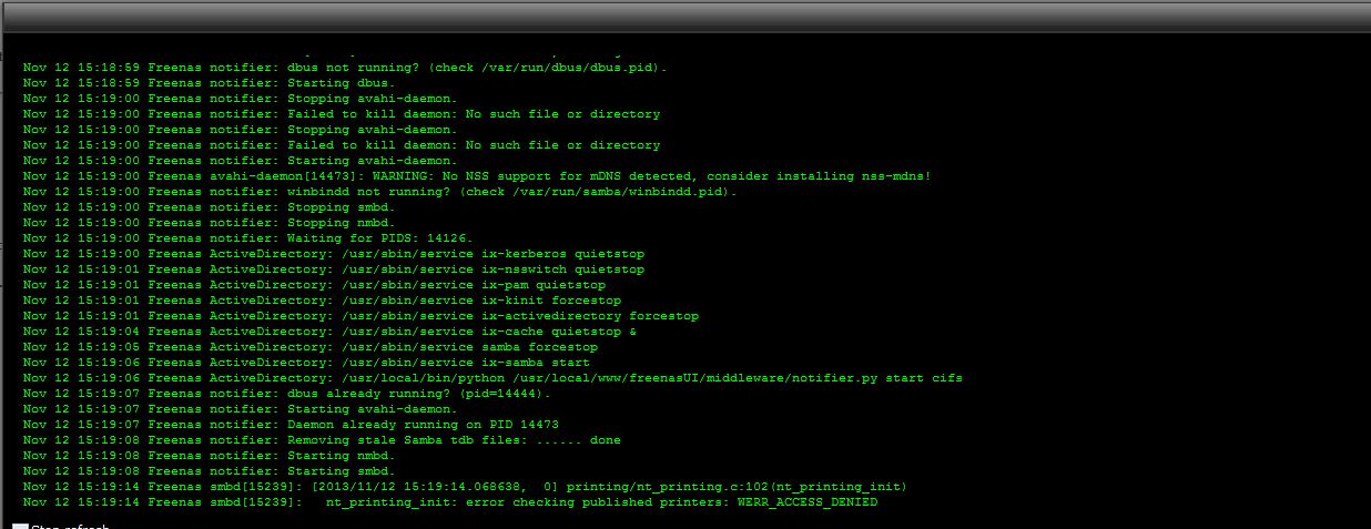

Connecting to Active Directory seems to be a common issue. I am having the same issue - I have scoured this forum and the internet in search of a solution. Double checking everything; time sync, simple admin password, extending time outs, using IP Address in the domain controller field. Just about everything I can think of. The settings always apply without issue, however when I try to switch on the service I always get the same error message, "The service could not be started."

I am having problem starting the active directory services as well. This is what I get (snapshot below) when I try to start the active directory services.
