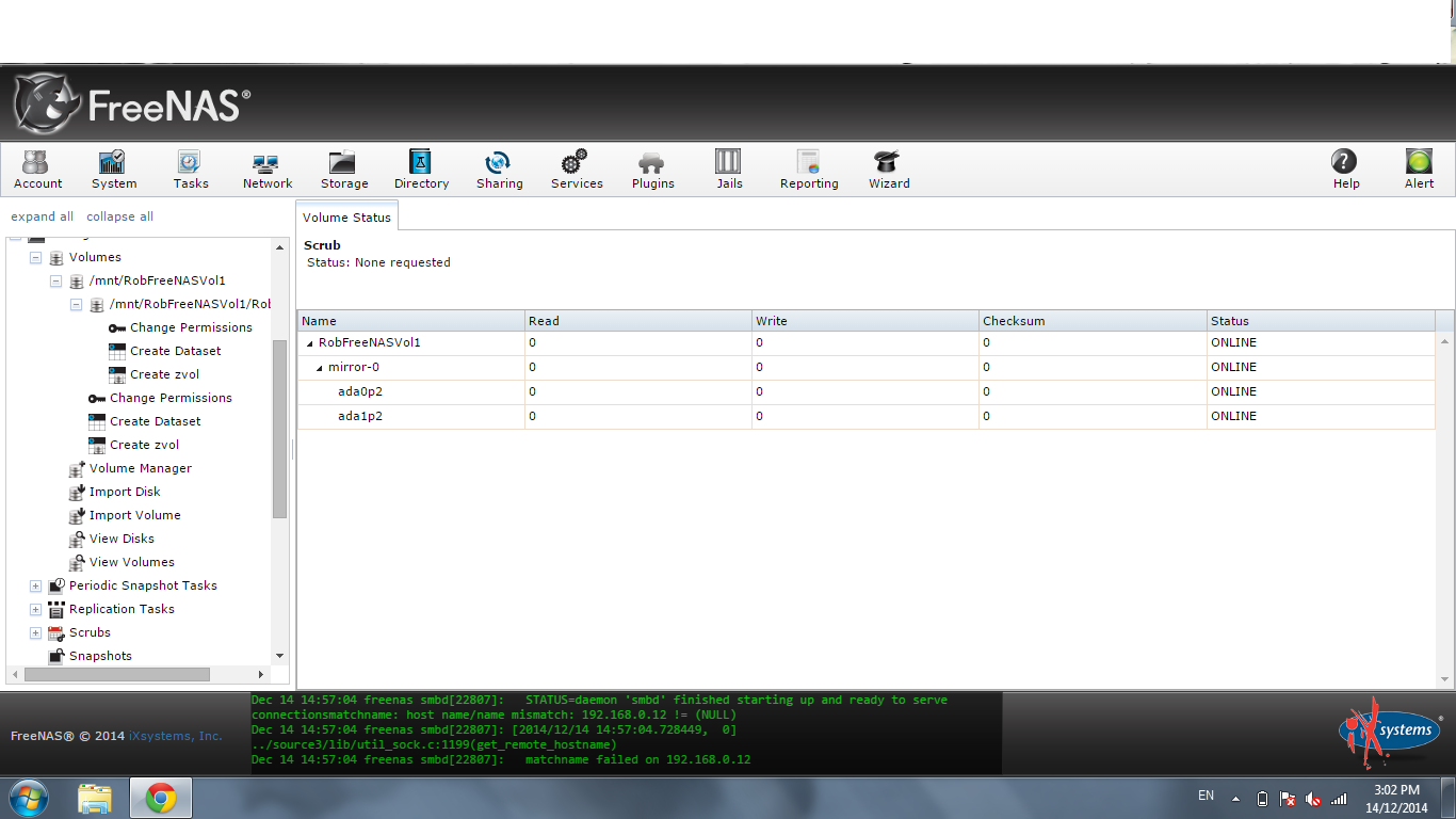

One more quick question:
I used the wizard to set up my volumes and I believe I picked auto for the RAID format, but I didn't exactly see what was selected. I'm just wondering how I can easily see what RAID my volume is in?
I only have 2 x 3TB drives so I wanted to set up a RAID 1.
*Below is a picture of my volume status* I assume this means it's mirrored? AKA RAID 1?
Thanks in advance.
