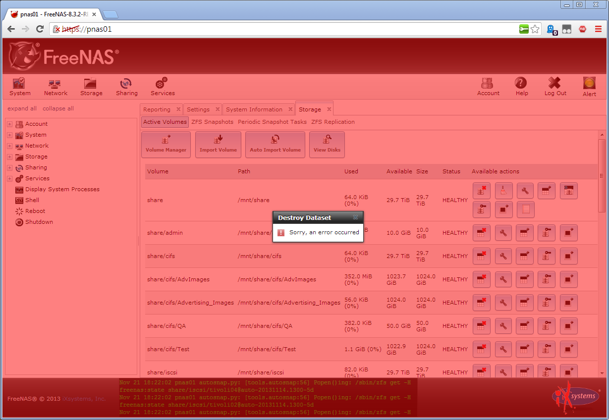

Earlier today I created a dataset named share/cifs/Advertising_Images on my FreeNAS 8.3.2 box that I am now not able to delete from the GUI. In fact I am not able do anything with this dataset. I get the same "Sorry, an error occurred" message if I try to edit ZFS options, change permissions, etc. See attached.
I want to make sure I don't make things worse, so before removing dataset manually from the commandline with "zfs destroy share/cifs/Advertising_Images" (presumably), I'd like to verify that this will remove the dataset from the GUI as well. The dataset has definitely been created:
[root@pnas01] ~# zfs list share/cifs/Advertising_Images
NAME USED AVAIL REFER MOUNTPOINT
share/cifs/Advertising_Images 55.9K 1024G 55.9K /mnt/share/cifs/Advertising_Images
Thoughts?

Wonders what is holding onto the dataset.... Does the share still exist? A periodic snapshot task? A replication task?

Ah, that must be it. I have parent datasets for each protocol, cifs, iscsi, nfs..., with snapshot and replication tasks set up for each. I suppose I will need to create separate snapshot and replication tasks for each dataset in order to avoid this issue.

I had a Test share under /mnt/share/cifs and was able to delete that without issue, so now I am back to having a dataset that for unknown reasons I cannot edit in any way.
I found this post which talks about editing /data/freenas-v1.db directly, but this is a production box and I want to verify the steps to get rid of this dataset and clear it out of the gui. I'm assuming I can remove it with "zfs destroy share/cifs/Advertising_Images," but I'm not clear on the "sqlite3 /data/freenas-v1.db" step. In the step below, shouldn't I be getting a list of datasets?

The storage_mountpoint table contains the mount points for each volume. In your case that one records indicates that volume 1 (as stored in the storage_volume table) is mounted read-write at /mnt/share. I don't think there is a table that holds datasets.
You can try to run fstat | grep Advertising_Images to see if there are any files open and what process is accessing them.

That's a good guess and I considered it as well, but I was also not able to do anything with the copy on the backup freenas box. It seemed to me that the issue had to be with the share/cifs/Advertising_Images dataset itself.
I was finally able to get rid of it by backing up and deleting the share/cifs dataset, then restoring share/cifs minus Advertising_Images.
I'm still not sure what the issue was, but at least it's resolved.
