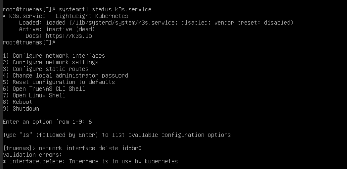

i set up a bridge for app kubernetes ,everything work.
but after a manual reboot , i got "web interface could not be accessed"
i try to delete the bridge and set up the dhcp on NIC via CLI

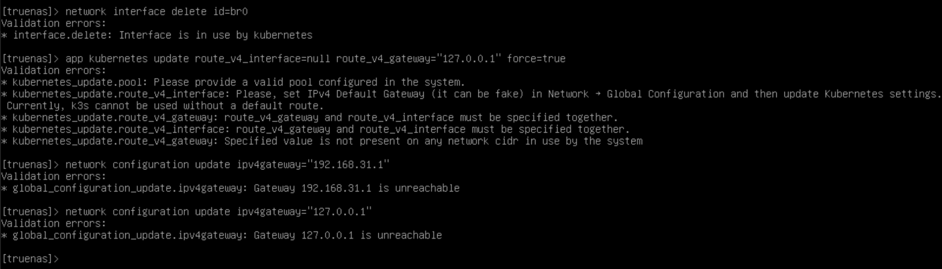

but the vaildation confuse me lots:
network config say interface is in use by kerbernetes
kubernetes config require a reachable gateway to setup interface
i have met this issues last week ,i reset all settings to default finally.
is there any way to solve this without lossing any other config except network.

I would suggest stopping the k3s service before doing your network changes...
systemctl stop k3s.service

Might be a bug,but would prefer that you update to 22.12.3.3 and verify the problem persists.
