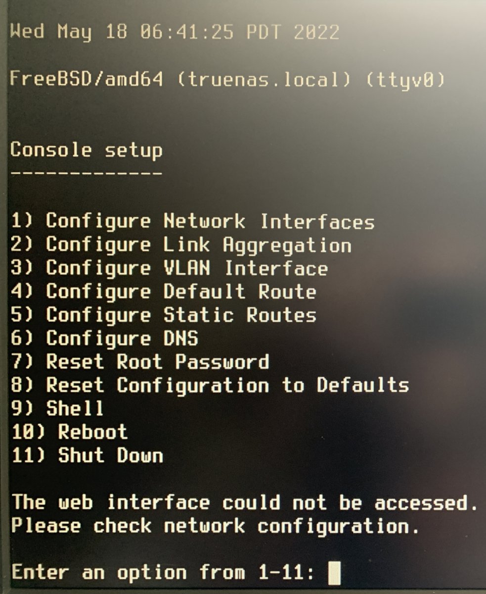

I have now gotten a Kingston 240GB SSD.
I successfully installed TrueNAS Core - 13.0, but I still can’t connect through my network. The server has a wired connection to my router.
I’ve attached what i see when it boots.
Where should i go from here?
Oct 22, 2019
3,641
Since this is a new setup, and before you can import the old config (done via the web GUI), you might have to re-configure the network settings from this menu screen.
Do you remember what you used last time? Is there any special / custom settings being used by your router?
Menu option #1 should allow you to set the IP address or use DHCP, or at least view the current IP address assigned to the server.

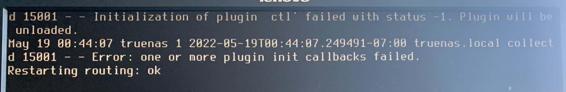

Last time I was able to do a headless install, so I got assigned an IP address automatically. So something is different this time around.
When I try to do anything with 1) Configure Network Interfaces I get the error I've attached.
Could it be worth a try to downgrade to TrueNAS 12?

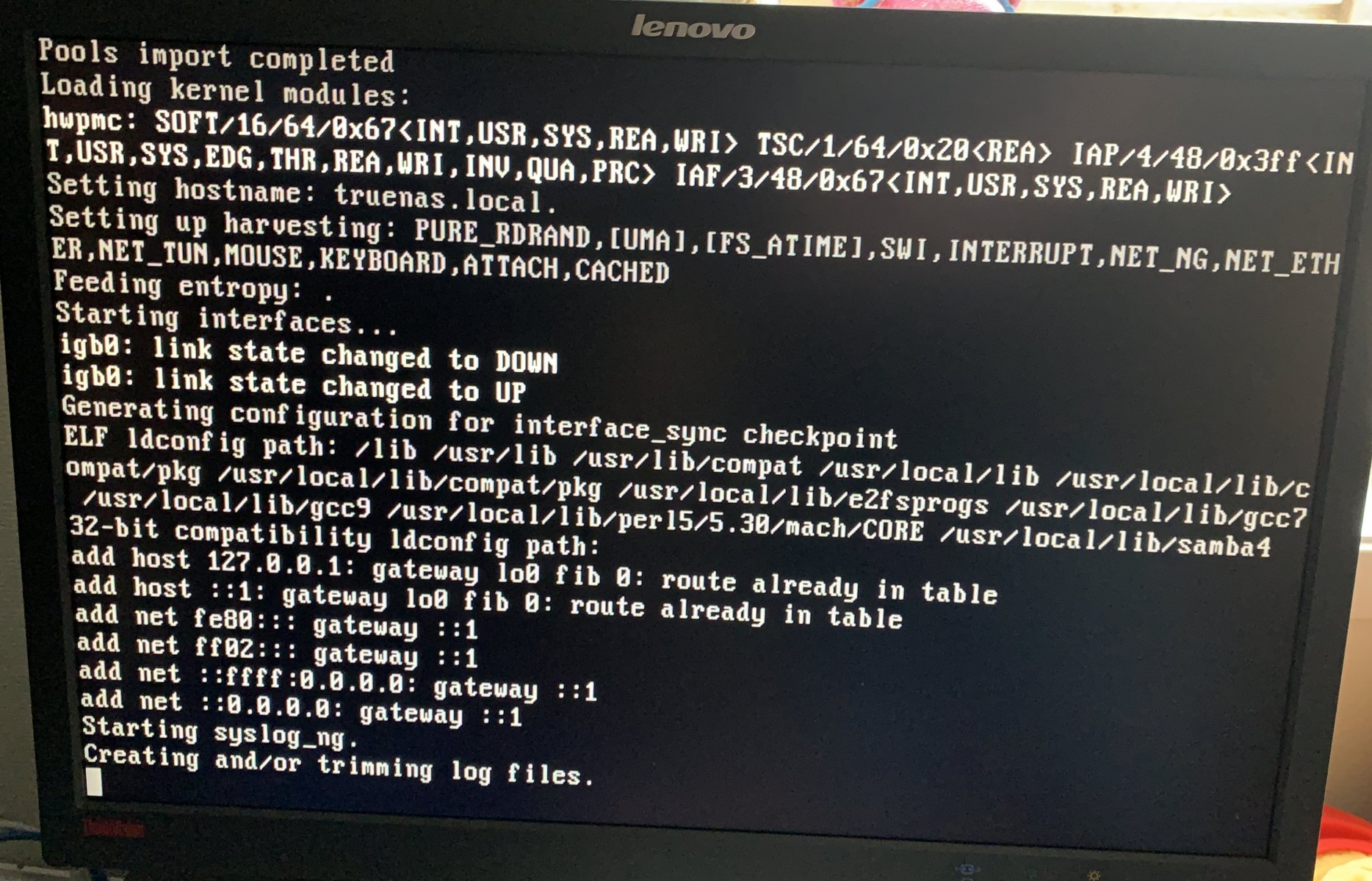

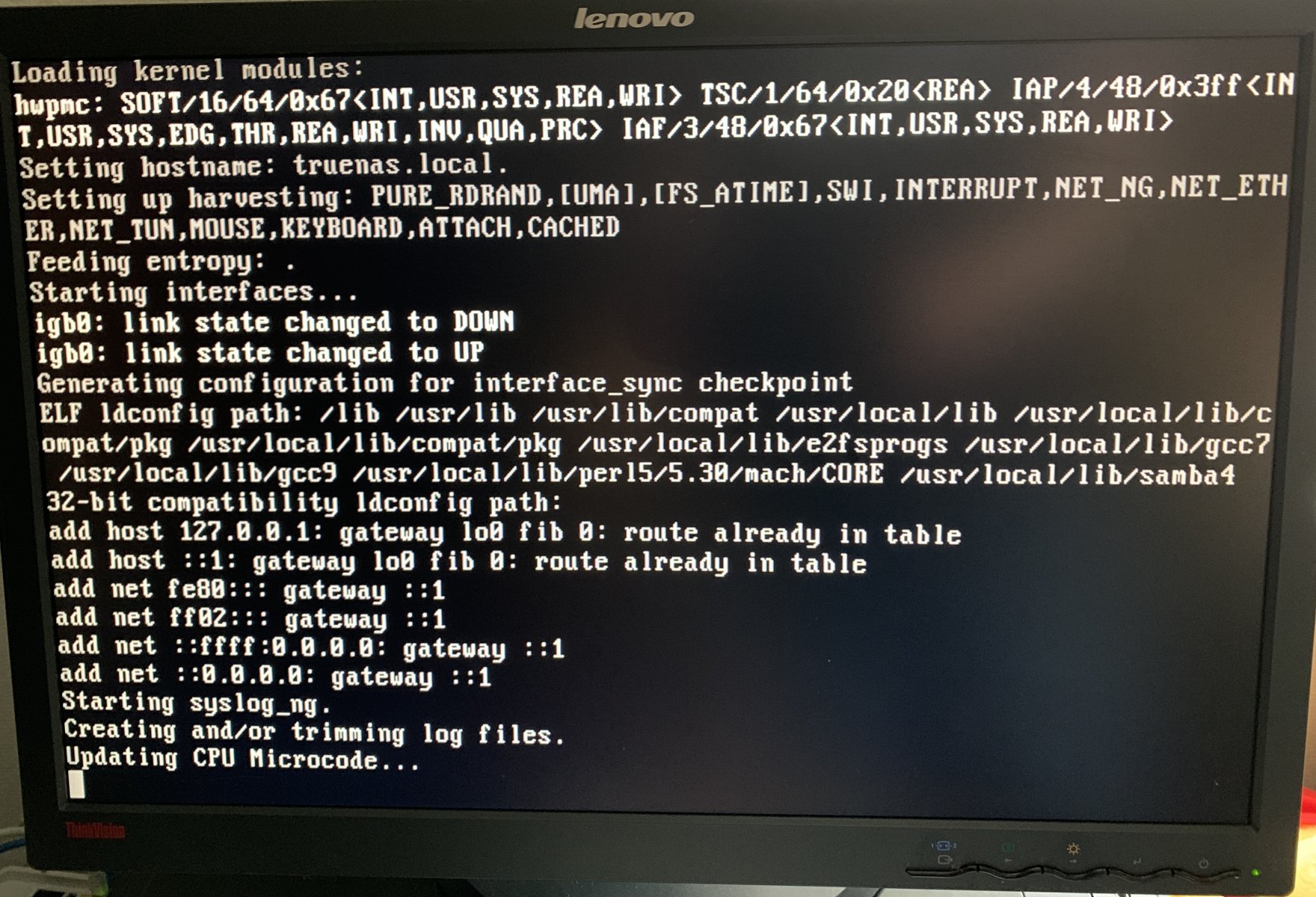

So I tried to downgrade to the legacy version TrueNAS CORE 12.0-U8.1.
This didn't work as well. After installing and restarting it didn't get longer than the attacked images when booting up.
Anyone have any good ideas on what i can try next?
Thank you.
