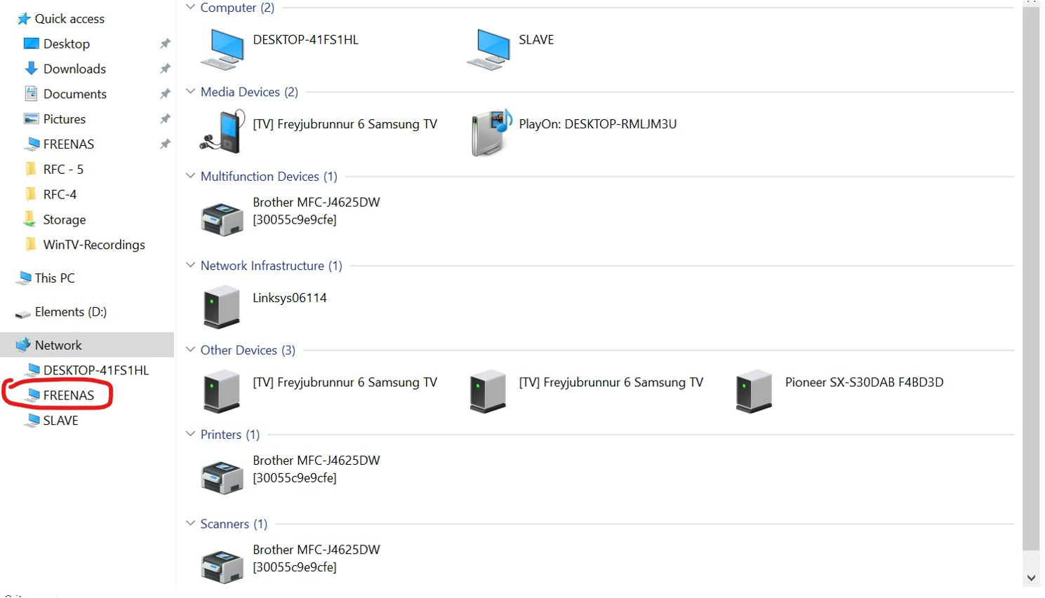

I did try to clear the credentials and shutdown and restart the file explorer as you suggested but no luck. Not sure how to add the shares by the IP.
As you can see, the name of the share FREENAS appears under both Quick Access and Network on the sidebar, but if I open Network, it's nowhere to be found. It's like this is on all 3 PC's btw.
