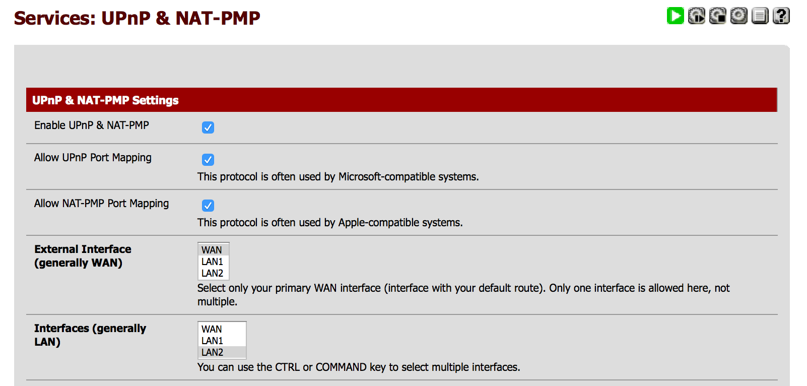

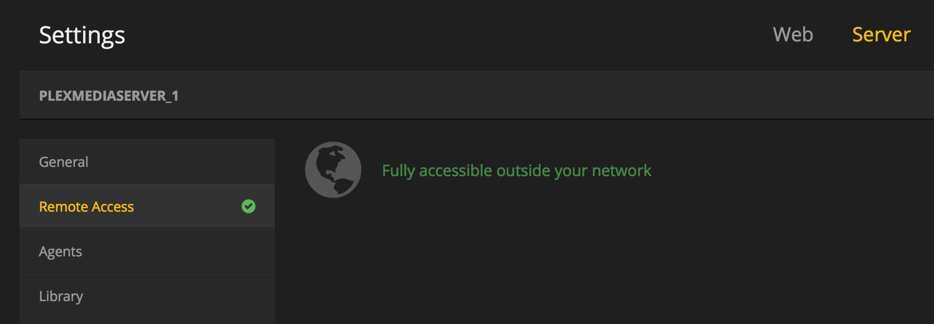

Question:
Why would you install Plex in a jail, rather than just use the regular plugin which ships in FreeNAS?
I've just installed Plex via the plugin method and it's not signing in to the plex web site with my account, it's either a routing issue on my NAS (I doubt) or perhaps it's because my newly installed Plugin is out of date (?)
So I figure Plex in a jail will solve that, right?
It might be your router, i'm using Plex from plugin method and it's working flawlesly, i even managed to make the movies downloaded by Couchpotato.
Is your router has UPnP and NAT-PMP feature activated? i'm using PfSense and turned on that feature on the LAN interface.
