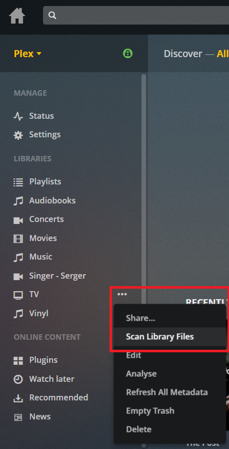

I followed the guide and thought I had everything set up correctly until I copied some new tv shows into one of the folders I had setup in Plex.
Plex does not detect any new shows that I copy to it. It seems like a permissions issue, but when I ssh into the jail, the new files have the same
permissions as the ones currently in that folder. If it is a permissions issue, im not sure where to modify them. In the plex jail itself? in the freenas dataset? on the cifs share? Anyone have any ideas?
This may seem basic, and I hope it solves your problem. If not I apologize for this noob post.
index.php

Might not be your issue, but are the shows named correctly for tv shows? ie .. whatevershow-S01E01.mkv ... I have had tv shows not show up because I didn't have them named correctly as tv shows.
https://support.plex.tv/articles/200220687-naming-series-season-based-tv-shows/

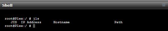

Once the jail is created, navigate to a shell prompt, either through the FreeNAS WebUI Shell or via SSH.
Once at a shell prompt, view the currently installed jails with the following command:
jls
You should see something like this:
JID  IP Address	  Hostname					  Path
1	-			   plex						  /mnt/Jails/plex
In this case, the plex jail has a JID of 1, so to get a shell prompt in the jail, use the following command:
jexec 1 tcsh

first of all, i want to thank you for the job you've done with this tutorial. it really helps.
however, im having problems folliwing it: when i run the "jls" command it shows nothing at all.
do you have any idea what could be wrong?
