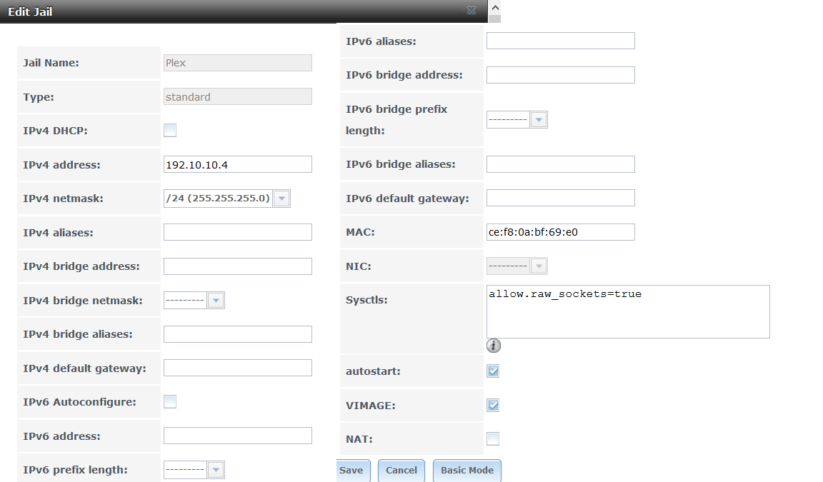

Hello my Freenas Version is FreeNAS-9.10.2-U6 (561f0d7a1) then after i needed to achnge the subnet the Nas is in from 192.168.178.x to 192.10.10.x after that ok Plex didnt work serching for server. Ok seems like the jail didn't get that so I did make a new jail and installed plex via this howto in the tread but still searching for servers nothing else... what did I do wrong? Didn't get the NAS the subnet change too?

You should not use a public address range for your local ip's. If you want that type of range is 10.0.0.0/24.
To answer your question please post screen shots of your jail setting and the network settings of your jail.

9uGtvc1
is this alright or you need something else?

Start a new thread, your issue is networking related and has nothing to do with this tutorial.
