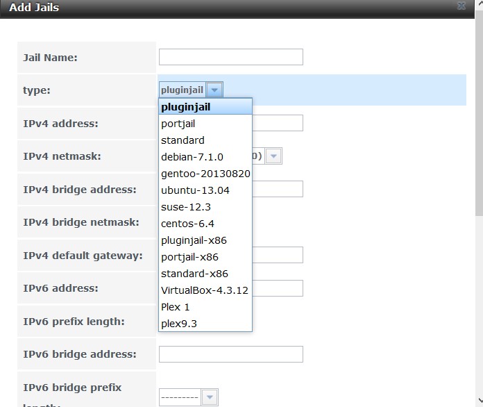

You should be able to select a jail type from that window. I used just a standard plugin jail.

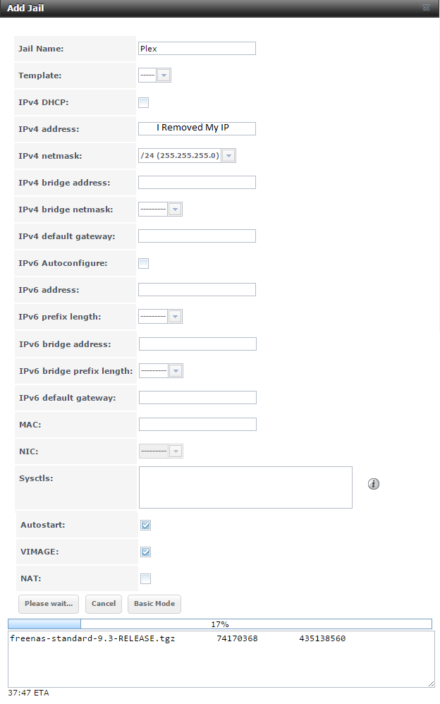

Every time I click "Add" after filling in the info, it downloads something called freenas-standard-9.3-RELEASE.tgz, after this downloads, I get an error that states it is unable to find the template.
