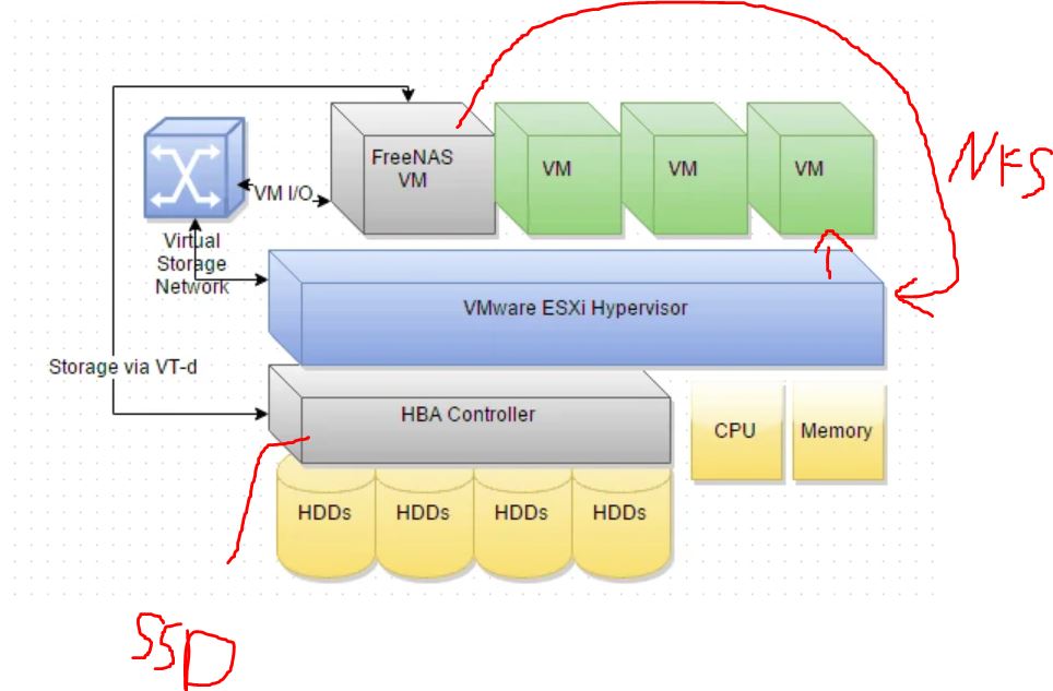

have you thought about an SSD for the VMs?
John Doe
633
you mean SSD within ESXi? or SSD's inside FreeNAS?
i have choosen 2 mirrored SSDs, as the datasource for the VMs. so I created a pool within freenas, an NFS share and passed this to ESXi.
I actually used the most parts of this how to link
advantage with this is, that you can use all the fancy features of freenas, like snapshots.
disadvantage is, whenever freenas is switched off and the VM os is not able to run completly on the memory, you might lose data.
i forgot to shut off a debian vm, did a freenas update and the debian vm got corupted. no problem, i could recover the snapshot but anyway, additional work has to be made.
