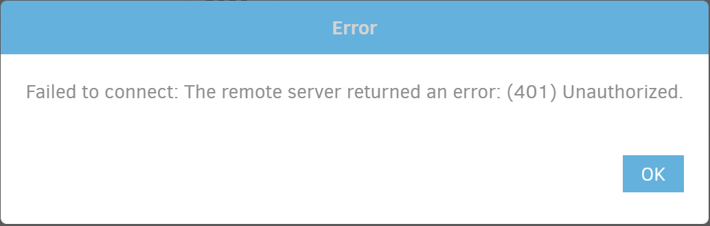

And I am getting "Failed to connect: The remote server returned an error: (401) Unauthorized"

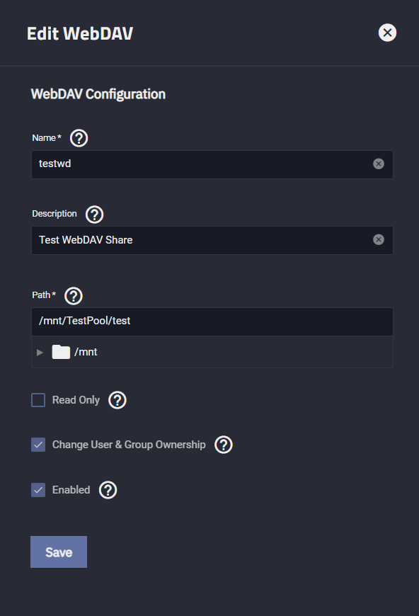

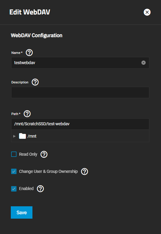

3. Added a webdav share
Its R/W and the permissions got changed in what look like a correct manner

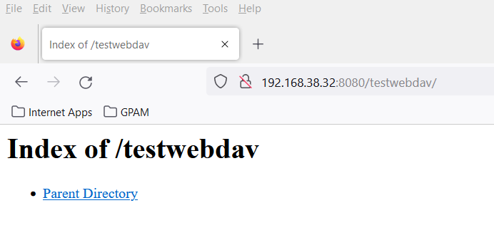

4. Using Firefox I browse to http://IPAddress/testwebdav and get a username / password prompt. Type in webdav/"Password" and I get an empty Index of /testwebdav

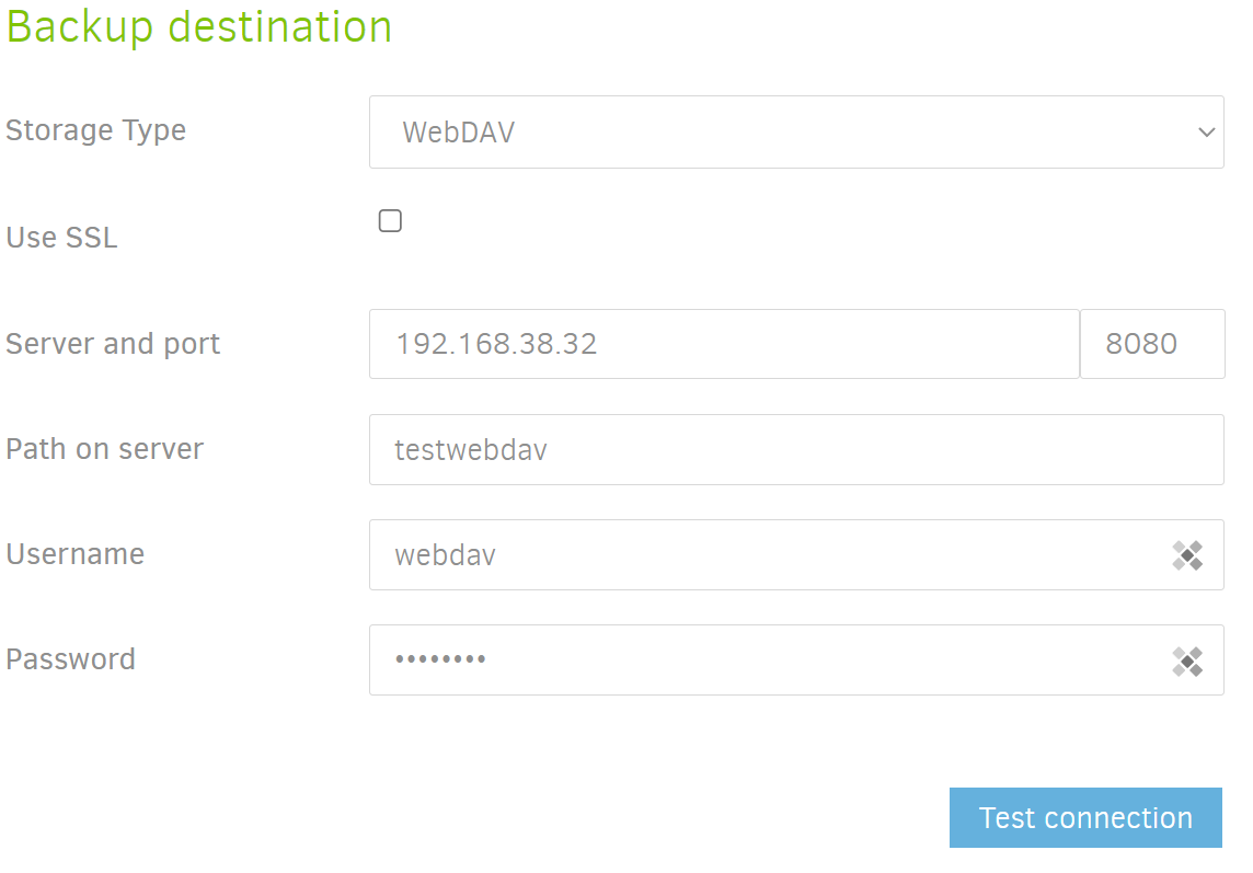

5. Setup a test backup with a few files using Duplicati
But when I press Test connection I get the
I have tried various / and \ beginning and end of the Path on Server and even tried the /mnt/ScratchSSD/test-webdav (which I am pretty certain is incorrect)
Anyone tried and got working anything similar?

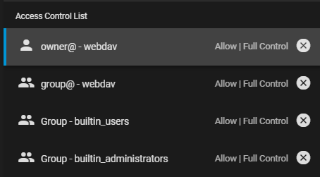

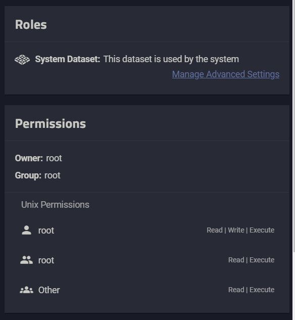

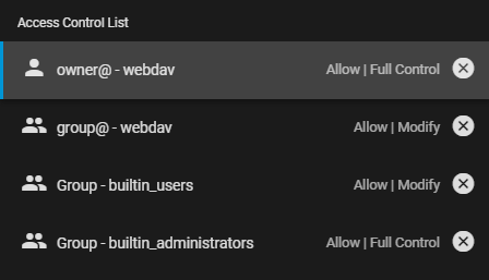

Permissions on the test-webdav dataset are:
webdav is owner and group owner.

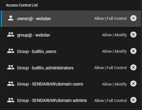

its a little bit confusing with webdav having two roles and one of them being modify only... can we remove the conflict and then see what happens.
When you access from your browser can you create and then modify files?

Honestly I am not sure what I should be able to do from the browser. All I get is
Am I meant to have more? Never tried to use WebDav before although your comment makes me think I may not have write access. I did restart webdav

Looks like Webdav needs a client for writing files .. there were browser extensions, but doesn't seem to be very active.

I have tried every option in Path on Server along with the correct username / password to get access to WebDAV from duplicati. Nothing works

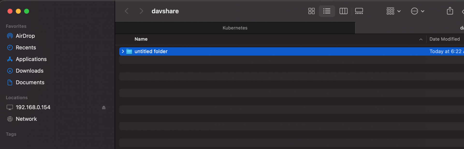

Works for me.
https://192.168.0.154:8081/davshare
Is how I mounted (via SSL). At least in your screenshot it doesn't appear you're setting the correct port.

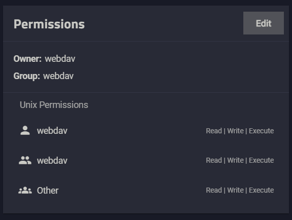

Dataset Permissions
Root dataset permissions /mnt/TestPool

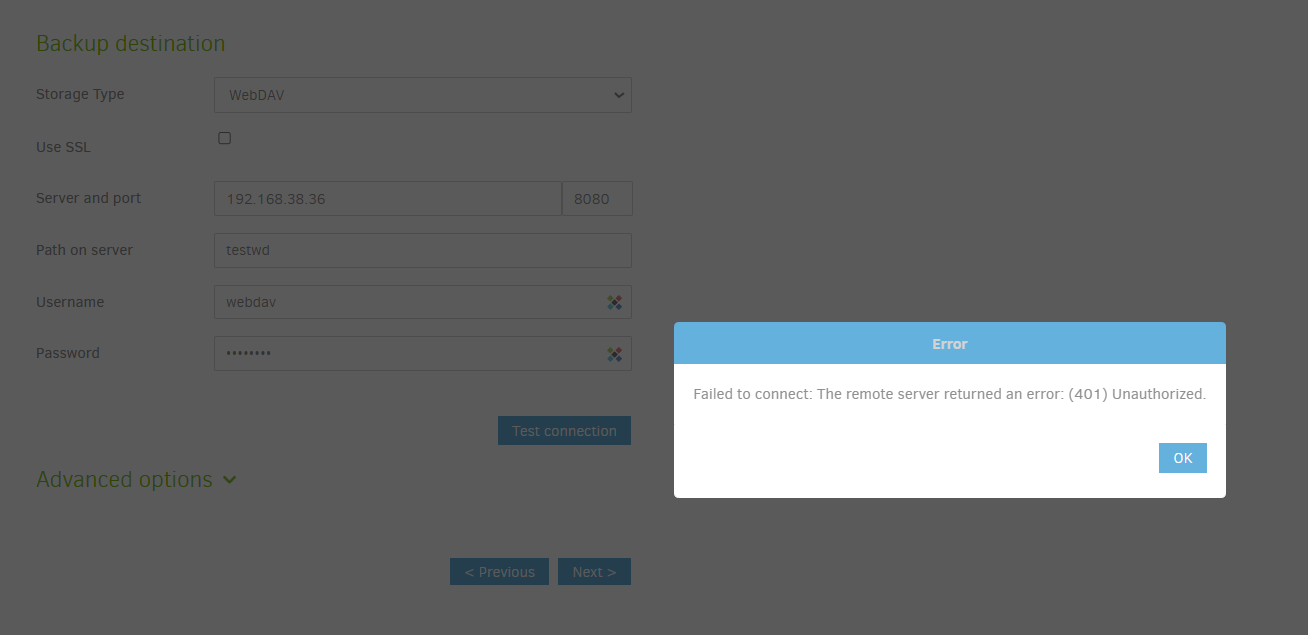

Duplicati setup
Not ethat I think I have tried just about every variety of options in the path on server field including full path, partial path, leading slashes, trailing slashes

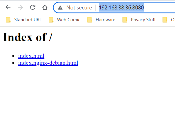

When I got to http://192.168.38.36:8080 I get a username / passwprd login prompt. I enter the expected details and this is what I get.

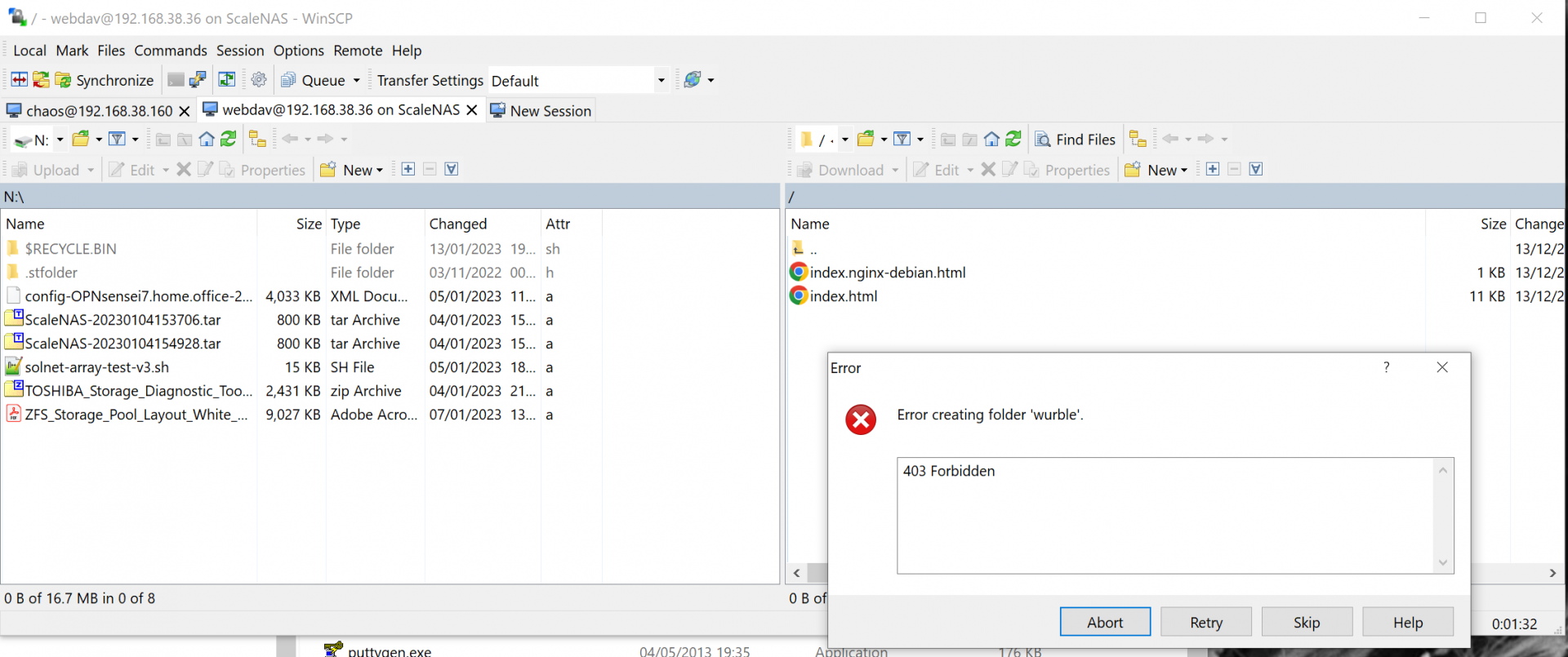

I then tried winscp to gain access. After editing the raw settings to add RemoteDirectory=/testwd it works or typing http://192.168.38.36:8080/testwd/ at the browser and I can see a file I uploaded.
It looks as though duplicati isn't passing the /testwd/ through, or is doing so in some manner than TN doesn't expect

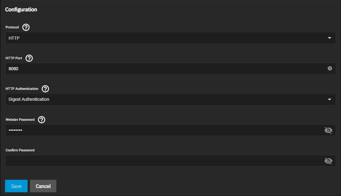

OK - that worked.

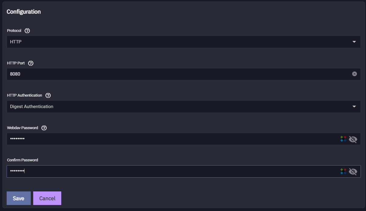

It was digest authentication vs basic. About the only thing I didn't change. It doesn't work if I force digest complaining "Failed to connect: The request requires buffering data to succeed." whatever that means - but basic auth works for this purpose, over a VPN.

OK - that worked.
My next issue is that on a LAN connection, 10Gb its running at 1.95KB/s with plenty of space (destination pool is 1% used)
Perhaps their client doesn't properly support digest authentication. If this is the case, I'd say this doesn't bode well for your general foray into using webdav with this client application (e.g. not very well-maintained). Maybe you can configure it to use SMB over your VPN?
