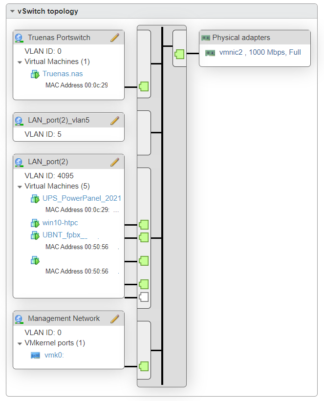

On a whim, I tried to isolate truenas to a separate portgroup bound to the same vswitch. Config looks like this.
Previously, Truenas.nas was part of the LAN_port(2) portgroup. Repeating the speed tests on the network no longer causes high cpu in truenas.
I don't see any negatives from the updated config but am still puzzled¿? Why this is happening in the first place? Network traffic is still being generated on the same vswitch and everything remains fully accessible.
