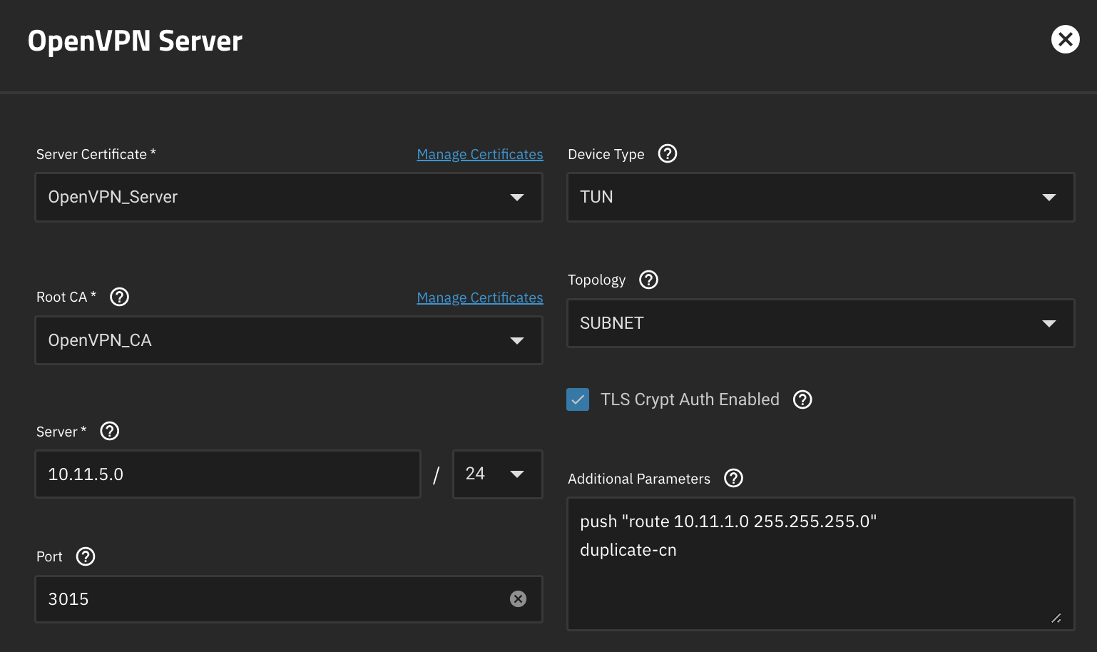

The problem as I see is in OpenVPN settings:
make sure you have the following configuration.
With this configuration when connected to VPN you will be able to connect to storeJ with the ip --> 192.168.8.251:20909 (remotely).
(by port forwarding only the port of the OpenVPN or none if you use a reverse proxy)
Anyway, i hope this helps.
fill the routes with your routes obviously (i didnt mean to say "use this config" rather i meant to just share my config)
