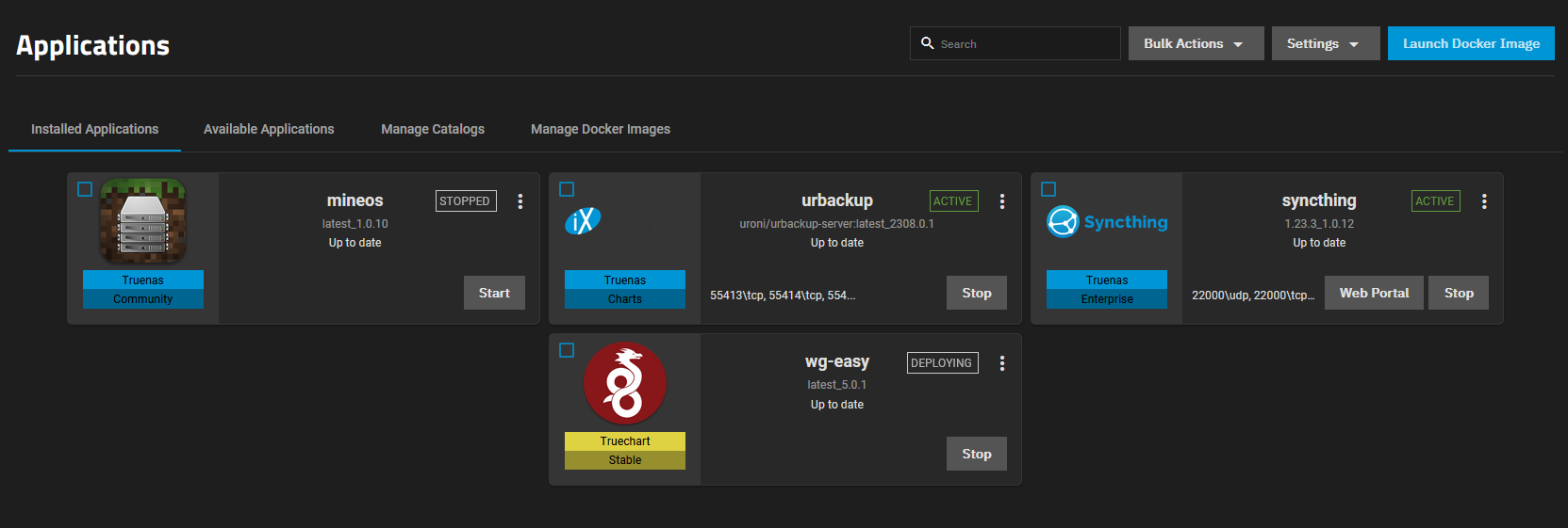

and I try to install wg-easy as an application again, but it has only been deploying for 5 minutes and is stuck there. Could that also fix the problem? It would definitely be better than running a VM just because of wg-easy.

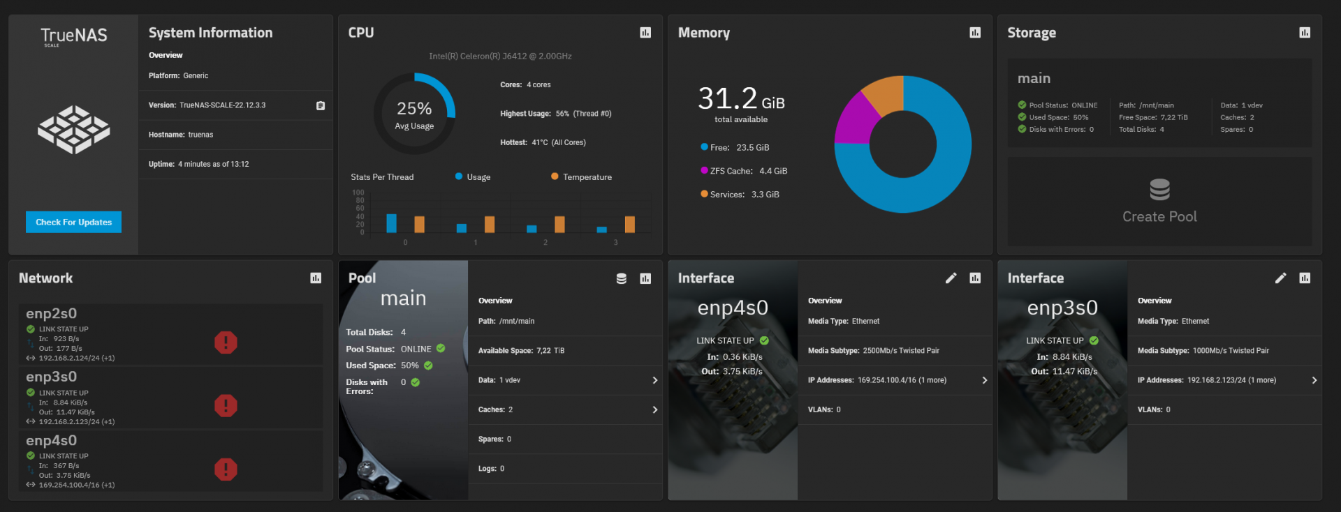

Looking at your picture. It seems you have multiple IP's on the same LAN-subnet? I wouldn't have it that way personally. Makes it difficult to rule out routing issues.
But you could otherwise try and troubleshoot from your backup-config. If you can't get around the weird network issues that popped up. But again, that is for git and how git communicates. And really shouldn't affect your NIC's.
But you could try and adjust to different values for core.compression. -1 is the ZLIB-default, 1-9 is how aggressive the compression should work. 0 is obviously 'off'. To see if that alleviates it.
source
One NIC is connected to my local network and I use the second NIC directly with a 2.5G card in my computer. The third Nic was actually for the VM, but I have now simply changed it. Now the VM with wg-easy also runs over the first NIC and only one is connected to the router. but that didn't help to fix my problem either.

And you have removed/disabled the configs for the NICs too? Not just taken out the cables?
If you then want the VMs to be able to communicate with the Truenas Scale hypervisor host over a shared NIC. You have to use a bridge.
But basically. Try and simplify your config. And add features i.e. complexity one step at a time.

It looks like completely deleting the NIC 3 settings fixed it. I won't be able to test it further until later, but it looks good so far. I'll get back to you in 1-2 hours. Thanks in advance for all the help

OK, here's my update: It works and I'm using wg-easy outside the VM again. The solution was that I broke my Docker installation of wg-easy from Truecharts a while ago and, to be on the safe side, I named the application "wg-easy-new" and created the host directory by hand so that it doesn't automatically use incorrect files who doesn't want to start the application. No matter whether via VM or when the application is switched on, there are no longer the errors that I stated at the beginning of the thread and I don't have to run a VM just for a VPN. Thank you @probain again for your help, helpful thoughts and your patience, as I can imagine that with the information I have given here, analyzing the problem is extremely challenging. Have a wonderful day and a lovely weekend.
