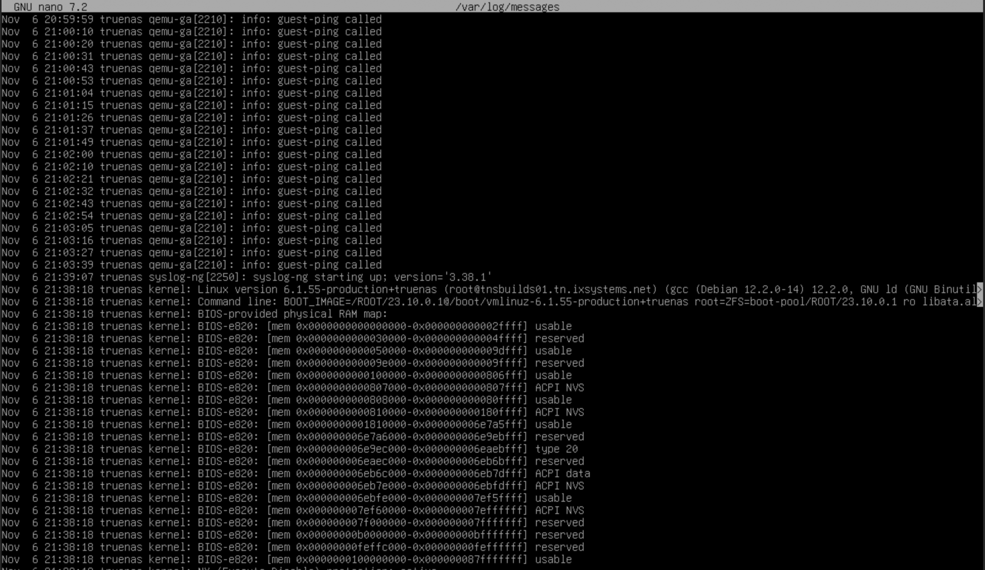

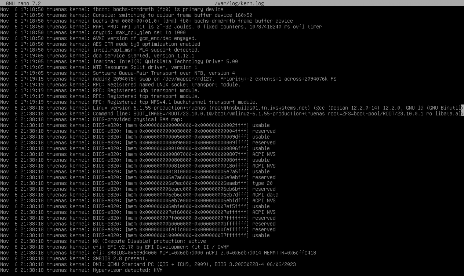

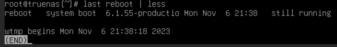

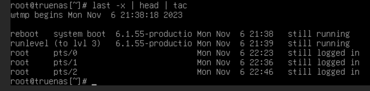

Removing SATA expansion card, moving boot disk from SATA SSD to NVMe, and now connecting all HDDs from SATA expansion card to onboard SATA controller didn't resolve auto-restarting of the VM. Neither did increasing the memory allocation from 16GB to 32GB for the VM (reported 26.3 GiB free of those 31,3 GiB available). Maybe I could try to reinstall everything instead of having it "upgraded" from CORE version, but I doubt this would help. Barebones install is now probably my only choice.
Reboot happened at: 21:38
Nothing useful visible in:
Neither in:
Probably useless as well, but:
And this is pretty much it what I looked at, besides:
And:

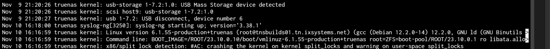

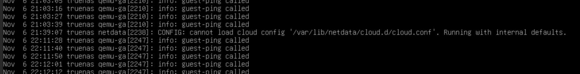

Now let me get back to my first point for a moment and make an update for it: having removed the SATA expansion card and reinstalling TrueNAS Scale baremetal, the server is still auto-rebooting! Everything it were doing is SCRUB running through the night and approximately 2 hours ago it rebooted.
Again, nothing in the logs to indicate the reason it rebooted:
Any help greatly appreciated.
