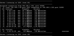

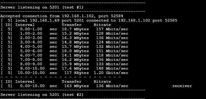

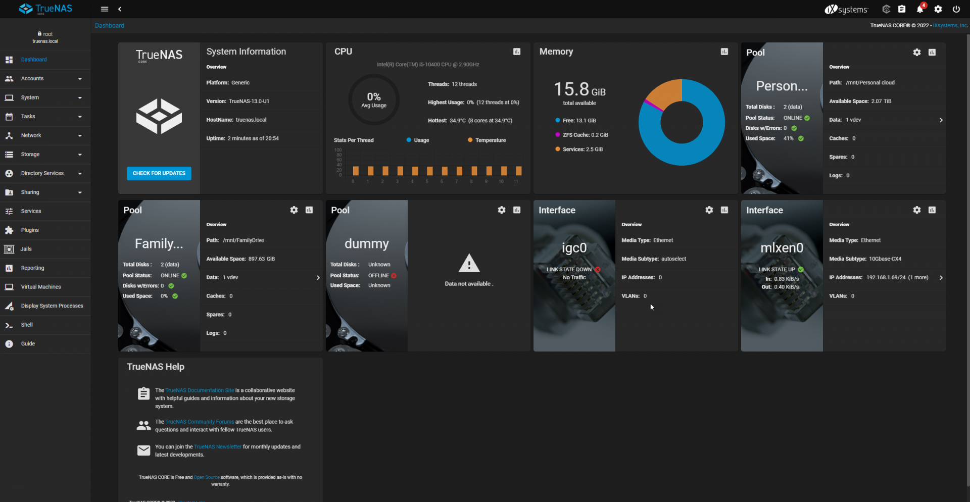

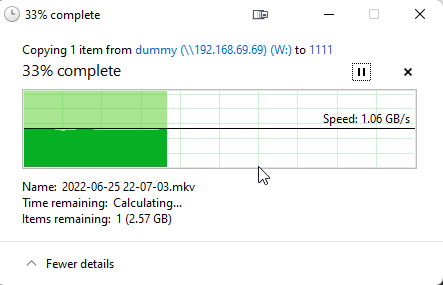

I'm new to TrueNAS and I'm not entirely sure to fix this. Essentially I had installed a 10Gb NIC recently onto my NAS and personal computer so that I could take easily access my files and make backups of files a lot faster. However it seems that I can only write about about 50MB/s max and and read 300MB/s in actual transfers and Iperf3 ranges from 100Mb/s to 200Mb/s. It seems to show that my computer and TrueNAS is connected at 10Gb but I can't get it to work where I want.

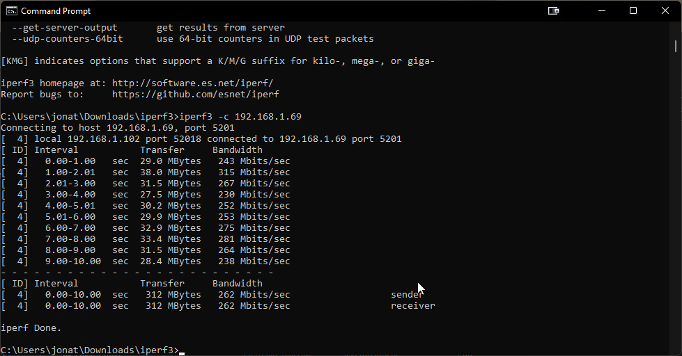

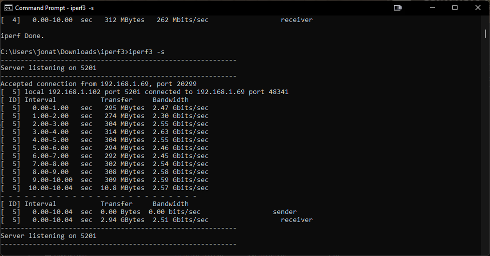

The iPerf results are indicating that you're only sending traffic at just over 100Mbps rather than the 10Gbps the card claims to be capable of. Do you get the same results if you reverse the direction of the iPerf test (add the -r option to the command)?
I also see the CX4 media type - check that it's firmly seated at both ends (using the locking clips or screws), there's no corrosion or bent pins, and the cable itself hasn't been bent or kinked. I haven't used that type of cable in a while but I have a vague recollection of there being different grades of certification based on the intended use (SAS, Ethernet, InfiniBand) so perhaps a replacement cable might be in order.

Writing to TrueNAS is a lot slower than reading form it. I made sure again that the NICs are secured well but it still gives the same result. I'll order a new dac cable and see if that fixes it.
