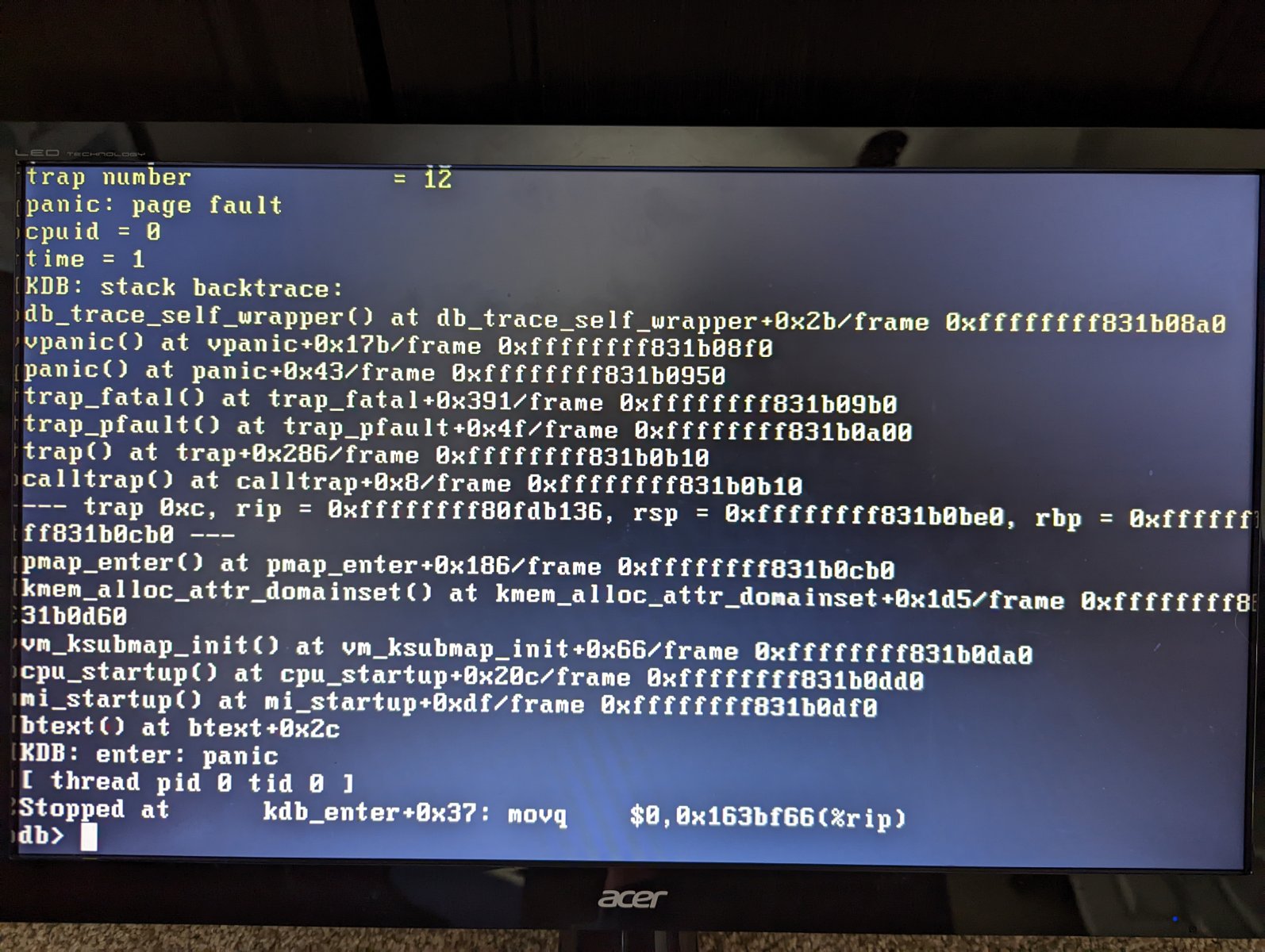

Hi All,
I woke up today with my Truenas setup non-responsive. It had no network connectivity and the drives werent making their normal noises. I plugged in a monitor and the system didnt recognize the monitor (no video feed). I rebooted and received the attached error message. When I reboot the system now its 50/50 as to whether upon reboot it will recognize the keyboard and monitor and regardless of the option I choose at the start menu it results in this error message. When I open the case the CPU fan and aux fans are running and nothing seems broke or burnt. Im assuming I may have lost the motherboard or CPU. I did try removing each of the two USB OS sticks to see if one of those died but it didnt change the outcome. Any thoughts? System specs below

Update: I reinstalled the OS on a new USB drive and removed all the RAM outside of one 8GB stick. It booted and I was able to import my pools and an backup DB. When I went back to install the RAM it looks like one stick went bad as it wont POST with it in.
