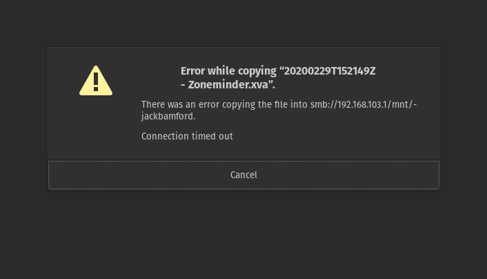

Had to reboot. But got the same problem as before connection just times out when starting to transfer. I give up on this TrueNAS.

this is all i get

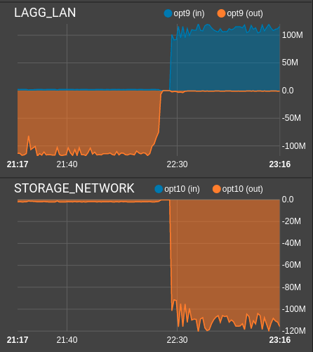

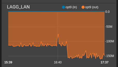

I have fixed the problem. It seemed to be a issue with the way the VLAN was configured on the Cisco Switch. All VLANs can now copy files from and too the Storage Network. Weird problem tho although the VLAN was still pingable. I am also seeing speeds that i wasn't expecting. This new Server ive upgraded too is pretty fast.
Cheers for your help.
