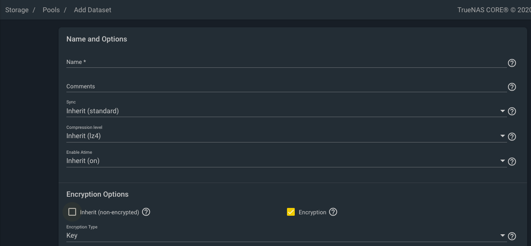

I have played with the new dataset encryption and it only seem possible upon pool creation.
I think I demonstrated above that this is incorrect. The pool is not encrypted. But when creating a new dataset, I have the option to encrypt it. Now, I'd expect that a pool created under 11.3 or older would need to be upgraded (I haven't tested that scenario), but it certainly appears that it's possible to add an encrypted dataset to a pool that isn't encrypted.
Unless there's a weird FreeNAS limitation, it's definitely possible.
