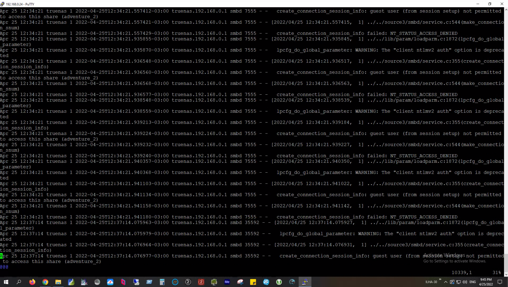

Looking in the Netgear Switch logs
I see that the 10 Gbps NICs go down and up automatically
to a point that the host of the reboot.
at IPMI does not accuse any problem with the Hardware.
The environment has dedicated air conditioning and sinusoidal UPS
pbasque
Apr 26, 2022
7
attached the print of the logs on the reboot from 15 days ago.

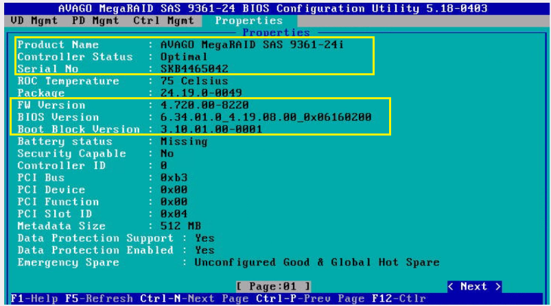

What's the exact model of your controller?
pbasque
Apr 26, 2022
7
AVAGO MegaRAID SAS 9361-24i

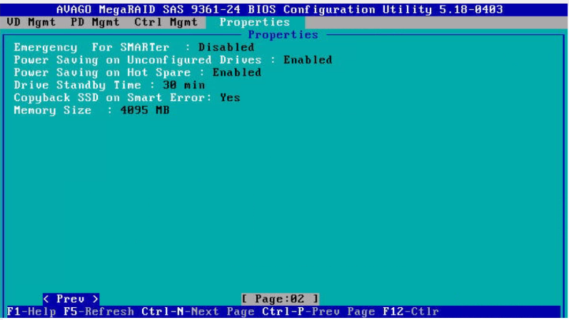

I'm sorry, but your adapter can't be flashed to IT mode. You'll need to select a different HBA. Running it in RAID mode is not recommended, and will eventually result in data loss.
