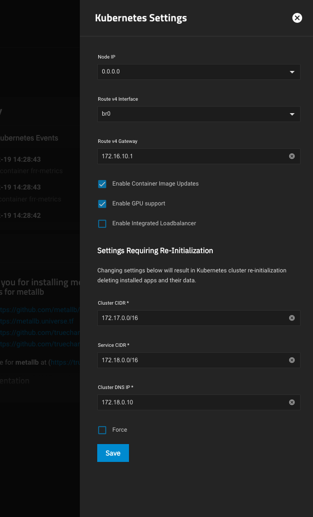

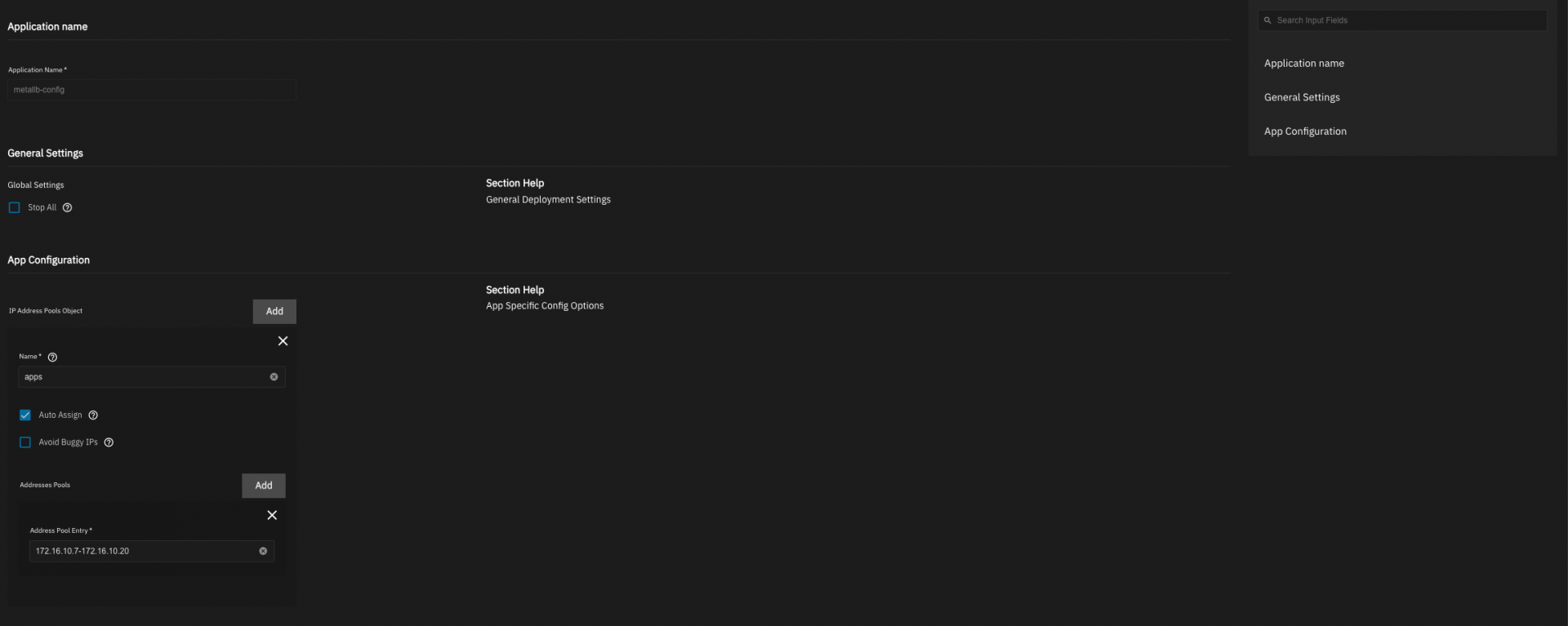

have you got any further with this investigation? I just installed Truenas Scale today and I'm running into the same issue. can't find a good tutorial to assign lan ips to my apps.
nikkon
Dec 16, 2012
171
thank you
nikkon
Dec 16, 2012
171

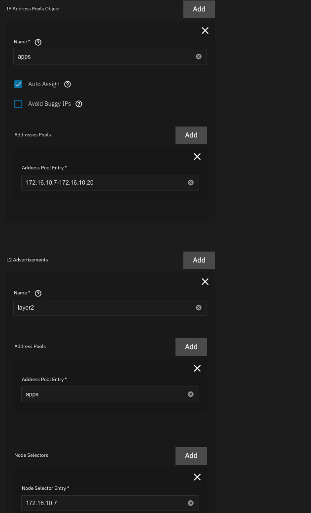

I followed this step by step. still getting plex getting the same truenas host ip.
my lan gw is 192.16.10.1
outside dhcp i have 10.7-10.20 /24
there is definitely something wrong as my metallb is crasing every 5 minutes.

I think your issue may be with the Address Pool Entry. In my case, my firewall/gateway's (pfSense) Primary Address Pool looks like this:
Subnet - 10.10.5.0/24
Subnet Range - 10.10.5.1 - 10.10.5.254
Address Pool Range - From 10.10.5.200 To 10.10.5.254
The metalLB address pool entry must be outside the range of what your normal DHCP server hands out:
metalLB config Address Pool Entry - 10.10.5.4-10.10.5.199
Any TrueCharts app you are installing will then get the lowest unassigned IP address in metalLB's pool, the next app will get the next available IP address, etc. You can, of course, assign the IP address yourself if you want to exercise a bit of control.
I hope this helps you.

My address pool is 172.16.10.50-172.16.10.55/24
all the rest are static mac mappings.
